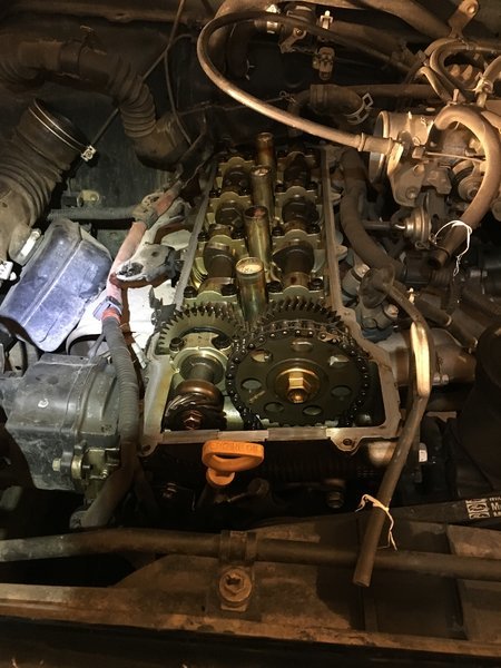

    Valve cover and spark plug gaskets, hopefully no more leaks:thumbsup:

    How hard was this? I noticed mine are leaking slightly and one into the spark plugs

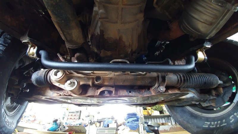

    sway bar rust removal. new brackets and end links

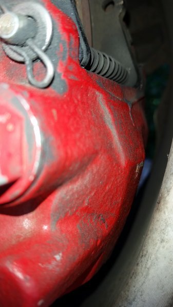

    Unfortunately not... if I would have realized 16" wheels were necessary before I bought my 33"ko2's for my existing 15's last fall I would be... I do have to replace fronts and rears... 265,000 on the rears and 100,000 on the fronts. To the best of my knowledge, wife was the previous owner and doesn't recall ever replacing the rear brakes. So I will be doing a full overhaul including fluid and reservoir.

    Steel wheel 15? Some will fit. The shape of the inside of the wheel can be an issue. My aluminum 16s give about 3/8 of an inch. What back spacing?

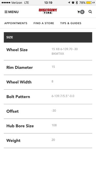

    I don't recall the Exact but I believe this is it...
    They are aluminum...

    Aluminum 15... nogo

    Not hard at all, just don't overtighten the valve cover bolts because you'll crack the valve cover casting.
