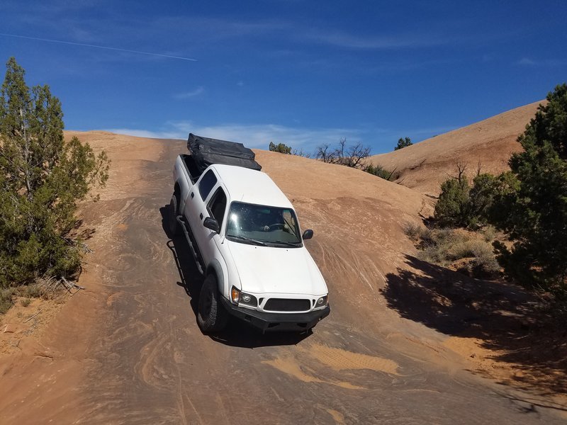

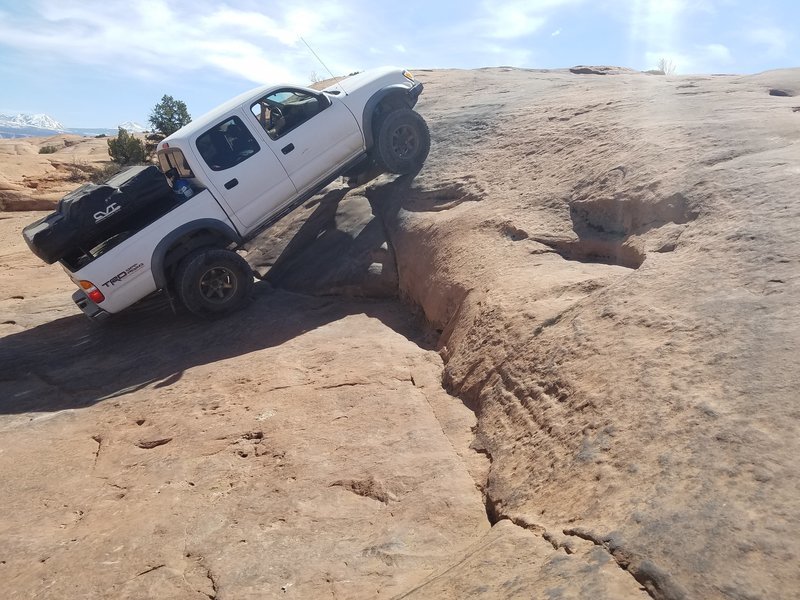

    I was there Saturday morning for the first time. Took my kid a did an overnight trip. Such a cool place. Was a lot of fun. Drove Fins and Things and the main loop of Hells Revenge. My locker wouldn't engage but still did ok.

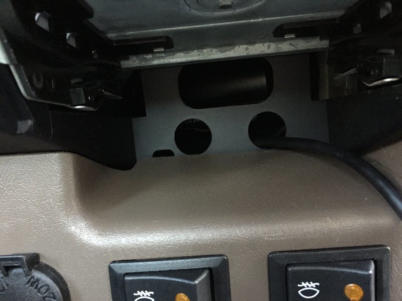

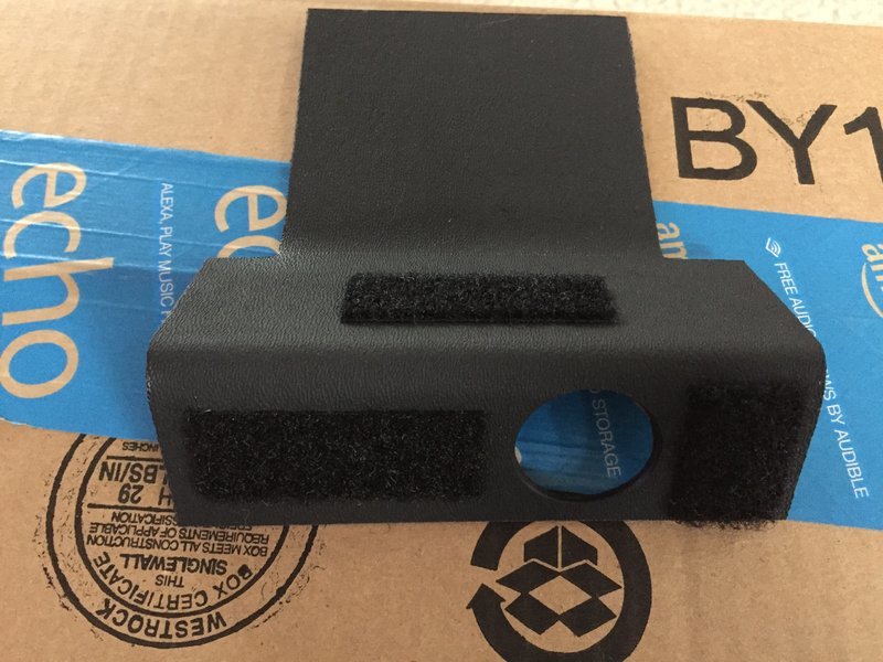

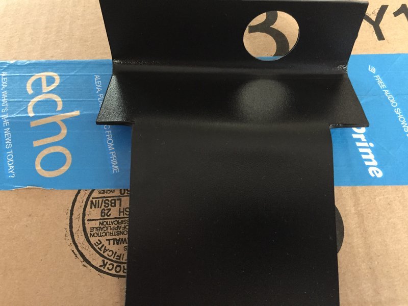

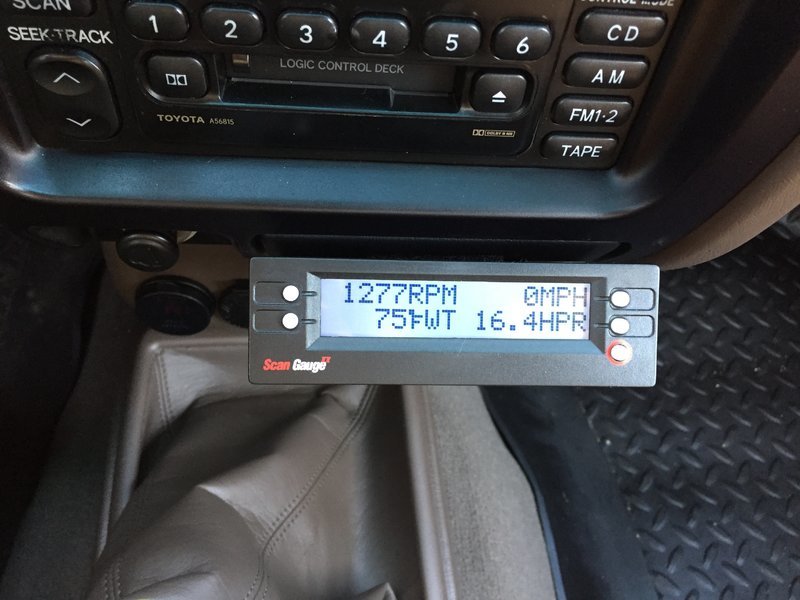

    So I didn't like any of the ways to mount the scan gauge. I set about doing my own using kydex. I don't want to drill holes in anything and I like to keep everything factory as much as possible. I bought my Taco new in 01 and the inside still looks new.
    The top piece of Velcro only provides a cushion in case it vibrated.
    Used the Velcro that came with the scan gauge and some double sided sticky foam. Stick the kydex to the bottom of the ashtray.
    Ran cable through hole in the back.
    Ashtray still works.
