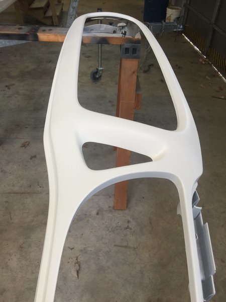

    Yes, but Not exactly. It's held in place by little plastic tabs that aren't removable without breaking them. If you break them, you can't reattach the inner to the grill. The tabs are part of the grille, come through the inner, and are bent over holding it all together.
    I took a Dremel and cut enough of the tabs so that I could remove the inner, but left enough so that they will still protrude through. When i reassemble it, I'll use JB weld to reform the part of the tab I cut off.
    At least that's my plan. It looks like it's going to work. I'll report back if it turns out to be a fail. Ha ha.

    Nah. I think I'm going to like this just fine. Plus, bumper ate my play funds. I'm
    In this less than $50 including the new corner lights, paint, primer, and clear.

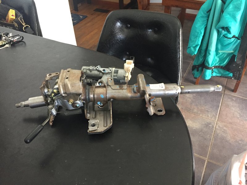

    Some and some more
    IMG_5310.jpg Not today but soon

    Hell yea!

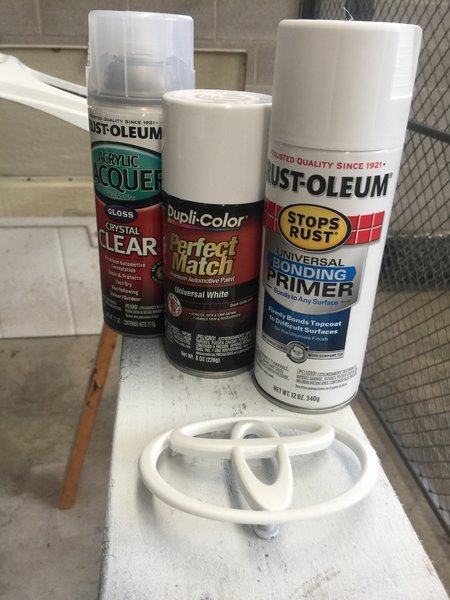

    Made a decision.

    Not a bad decision. Wait. You truck is white, right?

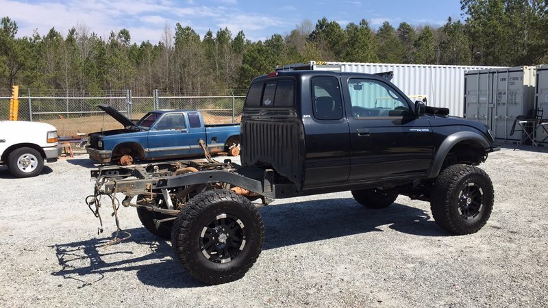

    Got the bed off along with everything else, now it's time for the painting to begin

    Or is it...? :spy:
