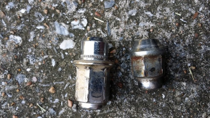

    OK, so a month ago I pictured a lug nut I had messed up when doing my front pads.
    I was sent a set of proper lugs by Squeaky Penguin.
    So I finally went to put them on, and it doesnt look right.
    Note the raised wear mark on my "wrong" lug, that is at a point higher than the
    bevel on the end of the "correct" lug, indeed the width at that point looks wider than the shank of the "correct" lug.
    Now that doesnt look like much for the "proper" lug to seat on.

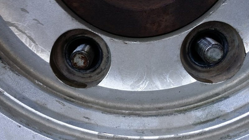

    I also had to remove the washer that came on each lug. They would float and rattle.

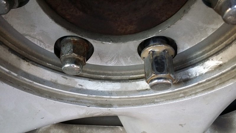

    Here is a better shot.
    So I just have the little angled bit seating.
    The "wrong" lug has more angled surface to grab
    The "right" nut is so tall it looks like the nut cover or whatever that plastic piece is wont seat right.
    So I am thinking something is a bit different with my 2003 PreRunner (or at least these rims) here.
    Is there supposed to be some recessed material/raised ridge that the washer that was included will seat upon?

    The one with the shank should be the correct lug nut, I don't think those conical seat ones are correct

    Yes they are. Jack the truck up. take ALL of the lugs off. Then try again.

    Sounds correct. The old lug nuts remaining are not allowing the wheel to rotate ever so slightly as needed to allow the shank of the nuts to move past the washer seat on the wheel.

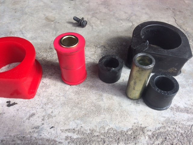

    Went to change the rack and pinion bushings today to my surprise first of the bushings came out quite easy
    then as i pull the second one out i noticed familiar number etched on the bushing Dang it! that's when i realize the truck already has ES bushings installed:annoyed::annoyed:
    I immediately inspect the lower control arm in hopes that it has them in as well but no luck looks like the only place where previous owner put in ES was the steering rack
    It was missing the washer though so i didn't feel like it was completely worthless to do it
    installed couple other things while the truck was on the ramps

    Did you get the 27mm sway bar bushing?

    Yes 27mm bushings
    Came in the full kit
