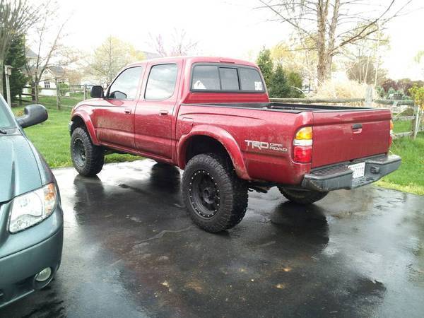

    just got my wheelers 5 pack and bilstein 5100s installed. the ride is amazing now. my old shocks were rusted through. tell me what you think!

    I think u have a nice looking truck man! I mean shit, the color choice, it's a 1st gen and a double cab :thumbsup: I guess I'm a lil bias, lol.

    HAWT
    I like that stance!
    How much you lifted in the front/back? (measured)

    hahaha thanks man. i love my truck till death do us part.

    thanks man! after the install i got another 2.5"-3" in the rear because my leafs were sagging. even though its only a 1.5" lift i got more since the rear was low as hell. as for the front, i have a 2.5" pro comp leveling kit with the 5100's set at 0" for now. i may go back and set them higher so its more level but not sure.

    Dude sick build, really close to what i want to do. How does the duratracs do for u?

    thanks man!!! damn a lot of people like my truck lol maybe ill sell it :p
    i should have pictures of the front end too if u wana see. i painted the grill surround black and the toyota badge is red, I'm happy with it.
    the duratracs are awesome, wish i went a size up. they're pretty quiet on road. as for off road they're awesome, especially after airing down a little. my next set will be either mtr kevlars or km2's

    great lookin truck 03doublecab ! I too am partial to red DCs ;)
    I'm gettin ready to pull the trigger on the Wheelers 5 pack too, but since the 5100's are on B/O im gonna go with the OME shocks and 881s.
    how was the leaf pack install? pretty straight-forward? did you need extended brake lines, shackles?

    Thanks!! well i work 2 jobs and am a full time student so i had a shop do it. no need for extended brake lines or new shackles. i just got the bushings and longer u-bolts. you may need to relocate the exhaust if you have a stock exhaust. its pretty close to hitting it and I'm sure when its loaded itl hit it. otherwise I'm extremely pleased so far. and the 5100s ride like a damn lexus to me since my old shocks and struts were rusted out. i do recommend the 5100s for sure, what were the one shocks you ordered? I'm sure those will ride better than what you have now

    Hes talking about the Ome Nitro Chargers
