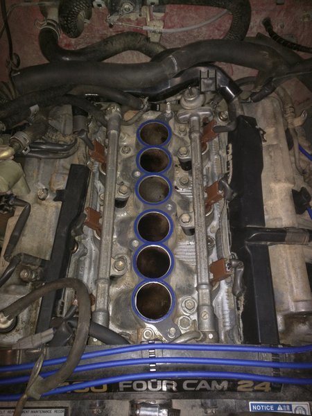

    Fresh from the liquor store. Time to swap injectors :D:thumbsup:

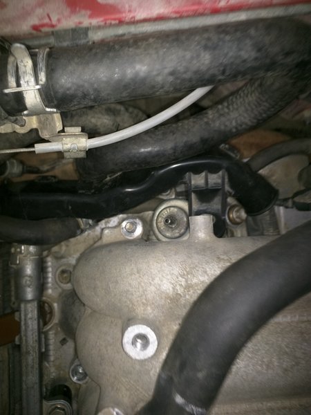

    Pro tip... On this back nut.... Drop it down into the cavern behind the engine... Gives you time to make another drink and contemplate your decisions:D

    Had some family call me to catch up so just getting back to it... Finally found the injectors! The journey continues... And we're on J&C number 3... Work to drink ratio getting skewed...:D I'll keep you posted if it blows up later :rofl:

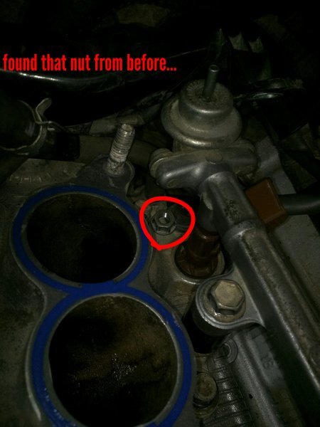

    Found the aforementioned nut...

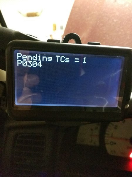

    Code went from P0302 to P0304 following injector swap!!!! Now I have to do it all over again with new injectors. Side note... Came in and the wife said you wreak of alcohol and gasoline :rofl: No extra parts and no explosions :boom: sorry for those betting on me blowing something up :D:D:thumbsup:

    Congrats on a solid diagnosis. Don't forget to sober up before a test drive. :thumbsup:

    No test drive tonight :thumbsup: Ultraguage already proved it's worth. showered and ready for a movie. Thanks to all for the suggestions and help. Hope you enjoyed the follow along. May have to do a proper write up when I swap the injectors so others can learn from my mistakes.. err... oversights :D As always, a big thank you to TW for the help and previous threads that loosely guided me :amen:
