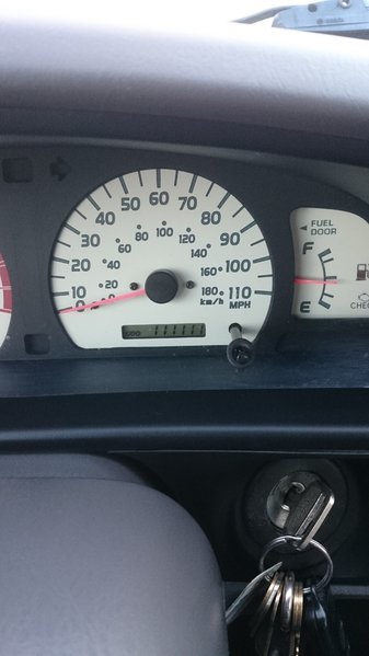

    Did this just now pulling into the driveway

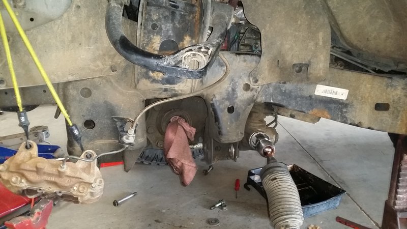

    Tore my front end apart. Went from this:

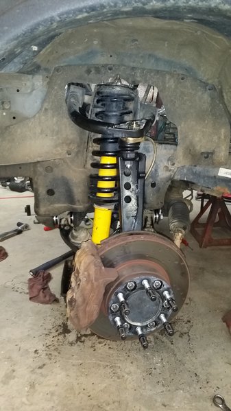

    To this:
    List of parts: Whiteline LCA bushings, cam bolts, UBJ's, spindle gussets, and threw my rebooted OEM axles in. (Rock Auto axles will get rebooted and become trail spares)

    Those spindles!!!

    I need to order some spindle gussets soon

    Gonna fly over the speed bumps now!

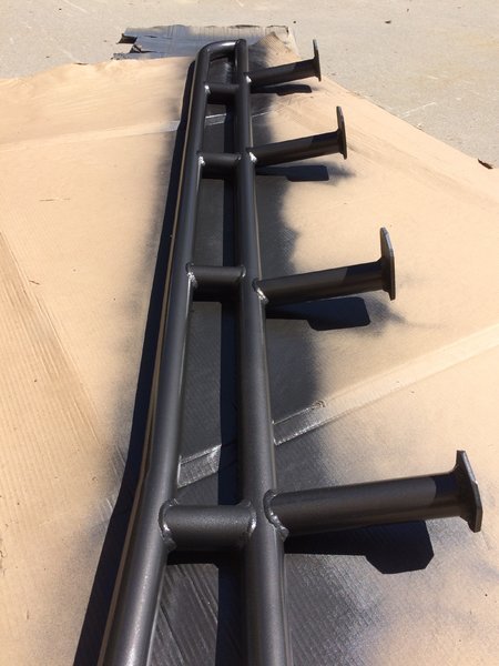

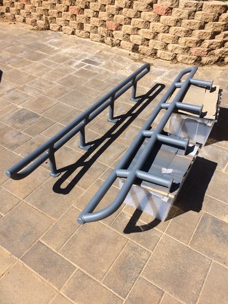

    This is happening...rattling the can...
    Stubb's HD-SKO's
    Up next...:welder:

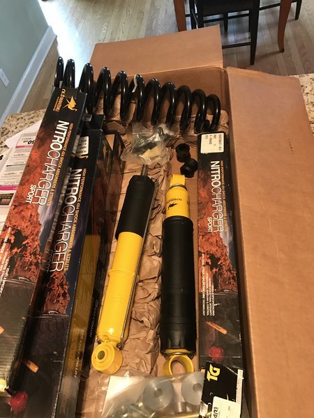

    OME kit came in today. :woot::taco:

    In all honesty, not too bad. One tip that I missed or just got wrong is to disconnect both tie rods. I just started on one side and couldn't move the steering rack enough to remove the back cam bolt and adjuster, so they got cut out. Which suuuucked. But, when I moved to the other side, I had not yet reconnect the previous tie rod which made the whole job much simpler. Nothing had to get cut, and I now have 3 bolts and adjusters which should clean up just fine should I ever need a spare.
    As far as removing the bushings, it's very straightforward. YouTube it. There were no surprises or uh-oh moments even though they were in fact completely seized.
