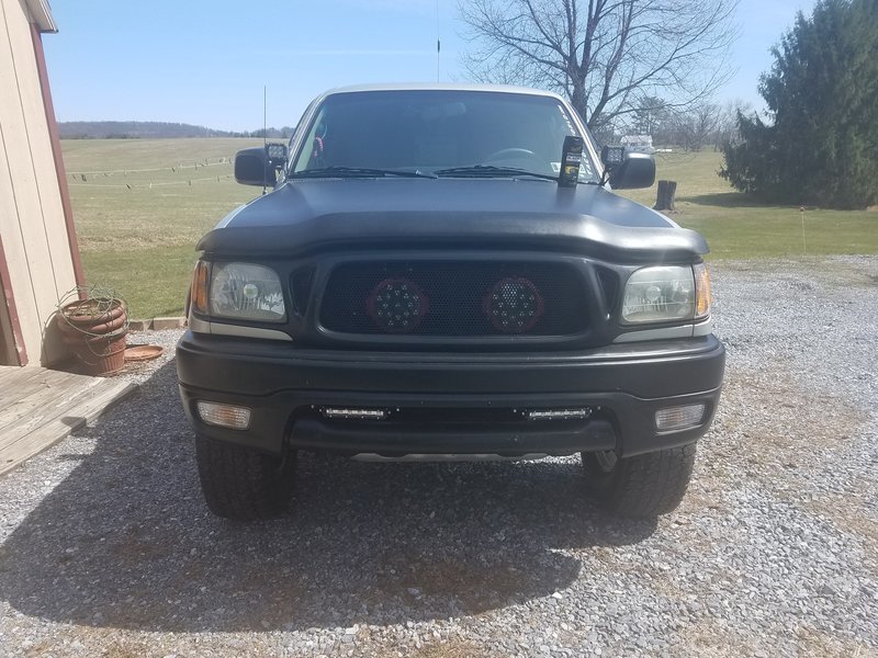

    IMG_2201.jpg Mounted a couple of rigid fog lights I have had laying around for years. Simple cross bar frame to frame, protects the lower radiator as well.

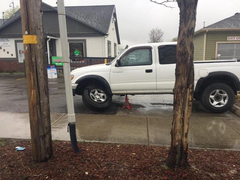

    It's not that bad actually. Just scraped the coating. I thought it cracked the flare, but it just needs cleaned and resprayed. :thumbsup:

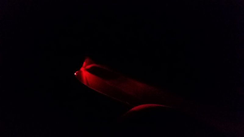

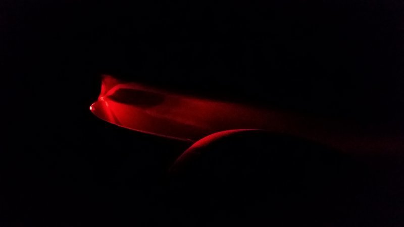

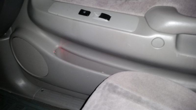

    Added a little mood lighting. :cool::cool:
    Also a bright LED next to it light map pocket when needed.
    Also dimmable. :thumbsup:20170402_110819.jpg 20170402_110843.jpg 20170402_110902.jpg

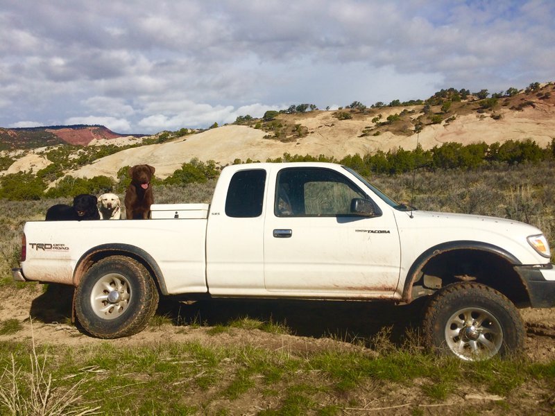

    Here's a flexy pic from today.

    Looks like fun, where's that?
