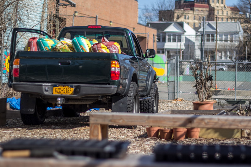

    Put it to work! First big day in the garden of the season. At least 1000lbs of compost in the back and some other stuff.

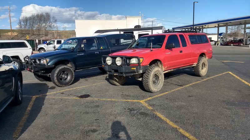

    Driving across the state today and decided to stop for food and gas. Found a pretty cool looking rig but unfortunately the dog inside didn't have any clues as to who owned it so I didn't get to compliment them.

    Sexy!!

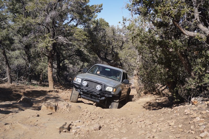

    IMG_6823.jpg Put new OEM LBJ on and wheeled it. Gold Mountain at Big Bear.
