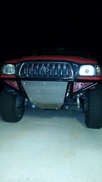

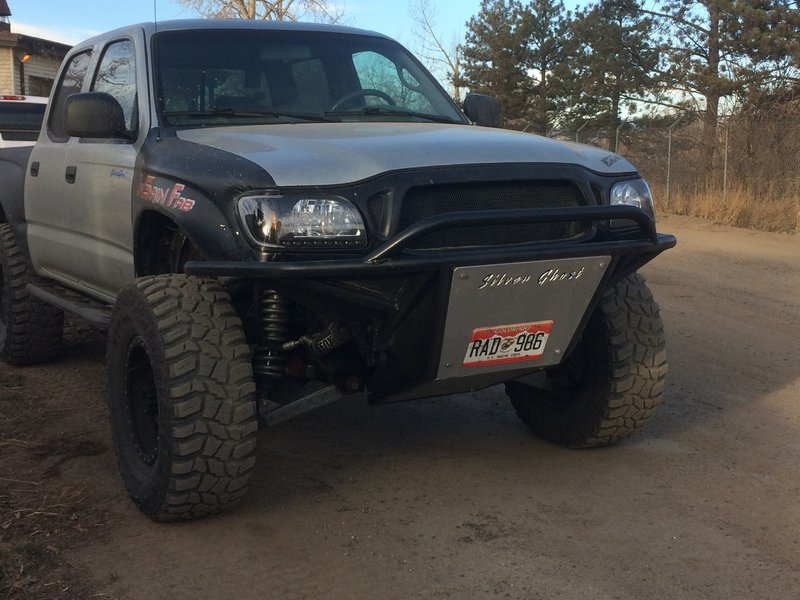

    Did you make it? or did someone make it for you?
  5. Apr 4, 2017 at 7:54 PM
    AmericanInfidel
    AmericanInfidel Well-Known Member
    May 17, 2015
    #155433
    80
    Grumble grumble, no. Had a guy make it..

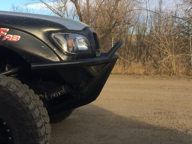

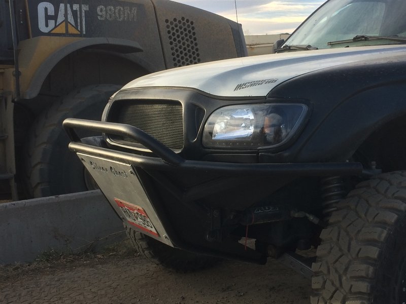

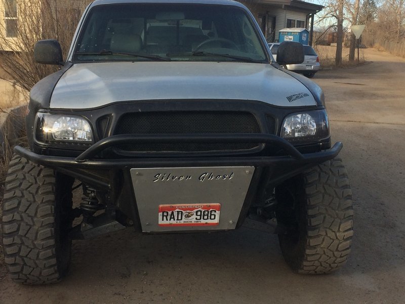

    That's fine. Just curious. Looks a lot like mine. But I just recently back plated the tube and added a tube over where i'm going to add a 30" baja light bar.

    Nice, black plated ? like an anodized finish ?

    Back plated the tube. Not black. My radiator core support used to be exposed like yours. But I added plate behide the tube to cover the core support.
    I also added the top tube.

    OH , I see. Miss read that. Nice I was wondering about that. Is your bumper welded on ?

    Nope. It's a bolt on. I extended the front of the frame an inch and drilled for a bolt. I'm also using the two original hook bolts on the bottom of the frame. I also added a winch plate. That's why it sticks out so far. Thats the closes I could get it and keep the angle of the skid plate where I wanted it.
    If you look close to one of the side pics you can see a bolt head.

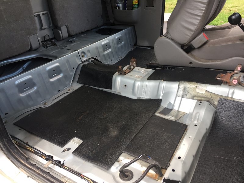

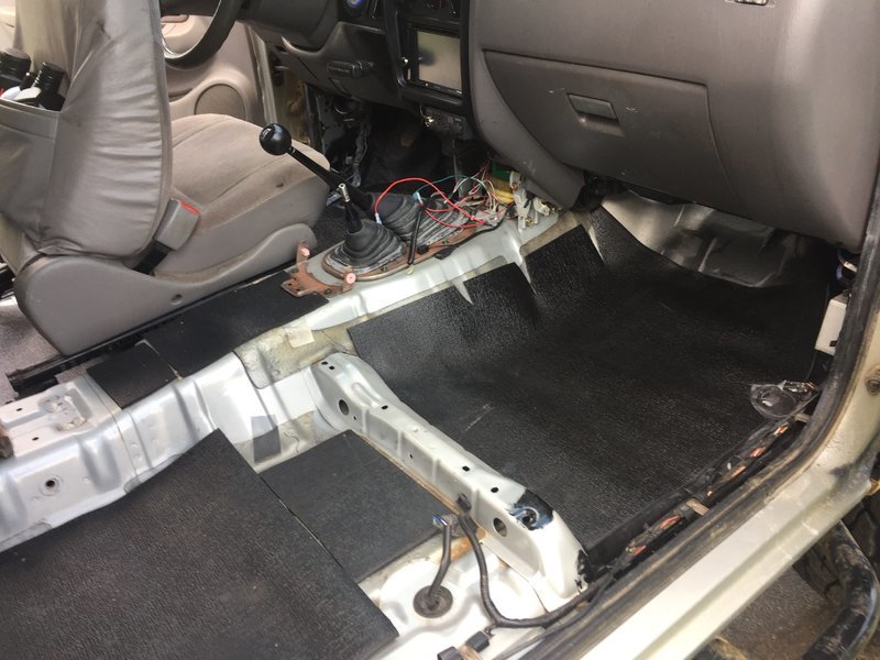

    The underlayment is actually this cut up:
    https://www.walmart.com/ip/Gold-s-Gym-36-x-78-Equipment-Mat/21672521
    I got it for $5 on clearance.
    The vinyl is through these guys:
    http://www.automotiveinteriors.com/...ith+Lid+Covers&color=57&state=NEW+JERSEY#year
    Hoping to install it next week.
    Cost me $150.
