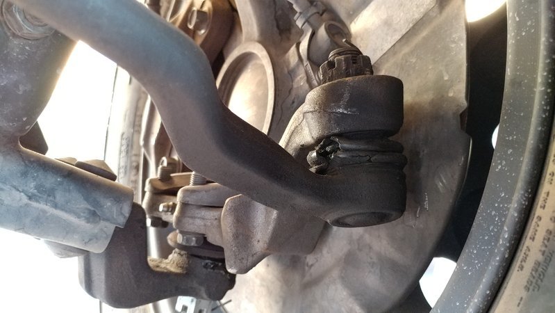

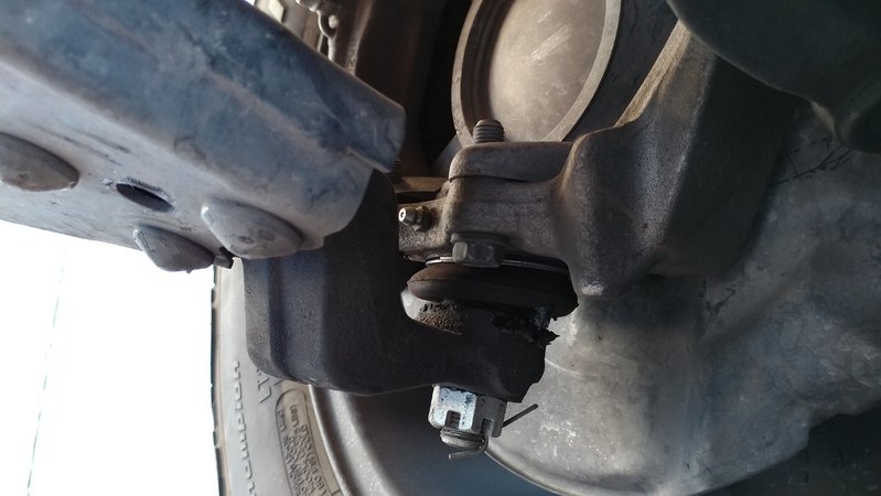

    With all this LBJ talk on here I got worried and decided to check mine. Turns out they look great. Look almost brand new! As for the tie rod arm boots, thats a different story. Thoughts? Dangerous to drive? Need replaced immediately? I can actually pull a good portion of the boot apart where its cracked away from itself with my finger. Driver side is cracked but not nearly as bad.

    LBJ is seeping a lot of grease...also not an OEM if that matters to you. its a Moog
    Id replace the tie rod. Not unsafe to drive. But eventually it'll be impossible to align.

    No kidding. Just rolled over 140K (139,980 of those are commuter miles) and I'm getting paranoid about some of the suspension and steering bits. Had an alignment done last year after getting new shocks installed. I was told they look good. Still paranoid though.

    Just looked at all my records from jack furriers. Totally forgot they swaped out the LBJ's out about a year ago. (Horrible memory) Theres no signs of ware or tears in either. Maybe grease from the previous ones?? Whats an OEM look like compared to a moog?

    Black and doesn't have the greese zert at all.
    Probably seeping grease from having too much. The plus side is you can just pump in more anytime you want.

    I'm about to roll over 129,000 myself. Alignment was done a couple months back when I had the OME suspension installed. Didnt mention anything about the tie rods though. *sigh*

    But arent the moogs unsafe? Seems like a lot of people are saying to stick with OEM? Or is it cause people arent paying attention and changing them when the need arises?

    The Moogs joint itself..is not up to par as the OEM ones. So they just don't last as long. Change them out often enough and they will work.
