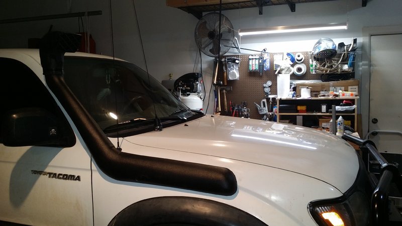

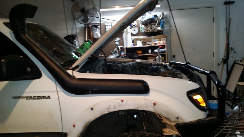

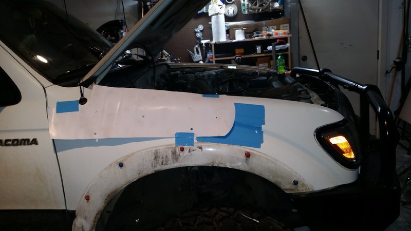

    After a year, I finally got past my fear of cutting a hole in my fender. Finally installed the snorkel.
  9. Apr 5, 2017 at 9:01 PM
    Misplaced Nebraskan
    Misplaced Nebraskan TTC #007 'First Gen Best Gen'
    Dec 22, 2016
    #205498
    16,893
    Zach
    Austin
    2001 Taco & 16 T4R TPE
    Which snorkel?
