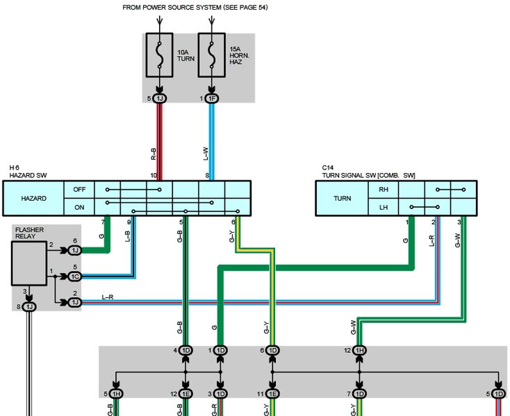

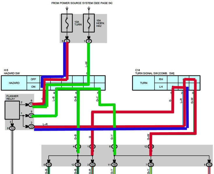

    There are only three components: Hazard switch, Flasher and Turn switch. And wires of course. I marked hazard light related circuit in green, and turn related connections in red. If none of signal works (no let or right) that one of wires marked in blue are not right or there is internal damage to either hazard light switch or turn position switch.
    Either one easy to verify. As you see everything is inside the cabin under the dash so the wire next to ABS is not relevant.
    It is also possible that you have some alarm installed and that screwed up the factory connections. I would diagnose from the power source:
    1. measure the voltage before and after the turn fuse. It should have 12V+ when Key is in "ON position"
    2. Measure the voltage on the hazard switch Pin 10 and 7 (should be 12V when hazard is in OFF position)
    3. Check connection on turn switch: it should have 12V on Pin 2 always and on either pin 1 or 3 when turn is switched left or right.
    I don't see any other option. Of course assuming all plugs are connected and there is no alterations to the wiring.

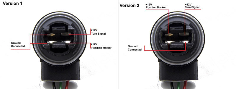

    Now you need to enlighten me about 2003 as what I see in the diagram does not make sense to me. FSM says that front parking are different from front turn signal. Other sources show you had originally 4157NALL bulb (orange, dual filament with flat base). If this is the case there could be two possible issues:
    1. There are two types of this socket:
    For classic incandescent 4157 bulb it does not make a difference as as this bulb has low power filament connected between left-upper and right-lower contacts, and high power filament between left-lower and right-upper contacts. As for LED switchbacks it all depends on the design, some of them might actually blow fuse if they are not matched with the socket: Type1 LED switchback has connected left contacts together and they will blow marker fuse if put in socket type 2. If LED bulb is polarity dependent it may work in socket 1 but not in socket 2 (and vice versa).
    If you are sure your socket matches the led switchback (it will not blow the fuse) there might be the second problem:
    2. I know some switchback LED bulbs (used for DRL and blinkers) require a power to the "white side" in order for the "orange site" to blink. So if you have front position light in front turn signal bulb (the white side) check if it works when you turn on the position lights. Also you may try to flip the LED in the socket to get correct polarity And again, if the socket type does not match the bulb you may blow the fuse as soon as you turn your markers on.
