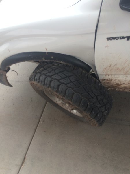

    IMG_0590.jpg Yep.

    that sucks man...

    Looks like the bolts sheared

    any damage to cv or steering components? hopefully just get away with a fender

    LBJ problem?

    Cv looks like ass, rack looks ok,
    I was just about to go up the mountain and stopped for gas so I guess it could be worse.

    That don't look right... o_O
    What I've seen is 1 of the 4 will back out completely, putting all the stress on the other 3. As long as the remaining 3 are tight, you can drive it that way in gentile conditions, meaning pavement only. Eventually the other 3 will begin to loosen, once you lose another one, then the remaining ones will shear from the turning stresses.

    Waiting on the tow truck IMG_0590.jpgIMG_0591.jpgIMG_0592.jpgIMG_0593.jpgIMG_0594.jpgIMG_0595.jpg
