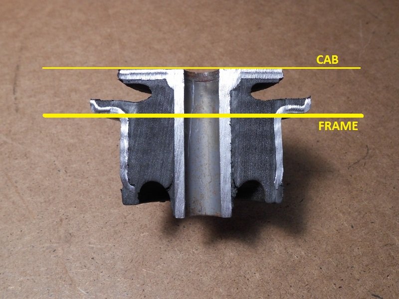

    All kinds of folks have, myself included. I saw a tiny bit of difference, the kind of thing one forgets about in a couple days.
    Now, "1/4"+ of sag"? There is only about 1/4" that the OE mounts can sag before they bottom out.
    The pic below is an OE mount at around 200K (no weight on it in the pic). Note the distance between the two flanges.
    Check the appearance of yours and also look for any deformation of the cab floor/cab back seam or deformation where the mount bolts to the cab.
