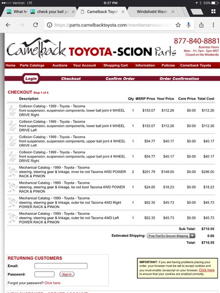

    Well. Do them now. Buy once..cry once..

    Hmmm? How come here's a driver LBJ left and driver LBJ right? Am I missing something? I just did the LBJs about 1.5 weeks ago and ordered from camelback. Driver LBJ was about $92 and passenger LBJ was $112.

    Good catach!
    That'll save him 200 bucks haha

    Does it say rack and pinion qty 2?

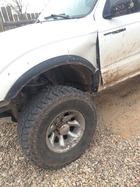

    Wait did I miss something? Did your LBJ fail?

    Bolts fell out/ sheared, luckily I was just pulling to get gas

    Well that's a relief, anything else damaged? But you should replace the other side, just to be safe. Then you'll have a spare to get you home if it breaks on a trail

    The cv pulled apart, upper balljoint looked bad and the inner tie rod.
    I need a new fender now also, wish someone made like a +2 or something not as wide as a 3".

    Damn that sucks. Glad it wasn't high speed

    Seriously. He's damn lucky.

    10ish seconds earlier I was going 50 mph, 5 minutes later I would have been going 65mph so I guess it was good timing.
