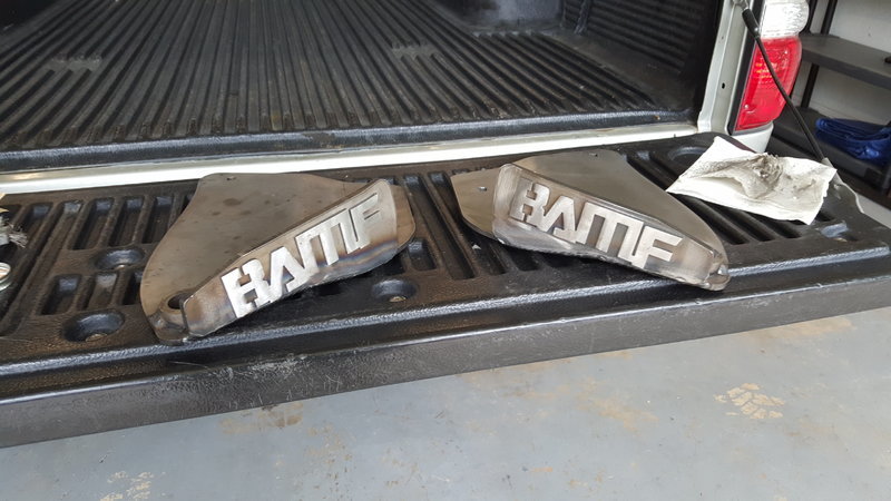

    Truck parts
    TheSaint likes this.

    Drop bracket lift and booger welds
    Same kit I got. :thumbsup:
    Robmonster117[QUOTED] likes this.

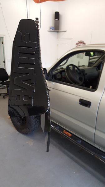

    Painted up my LCA skids today. Going to bolt them up tonight when I get off work.

    Same kit I used as well. AirCabinMan is good to go.

    Excellent good to hear! Got to knock this out before summer wheelin can commence

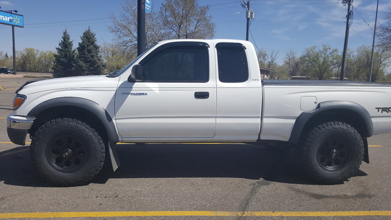

    It wasn't all done just today, but in short order following the purchase of the Tacoma.
    AVS Vent Shades and Bug Deflector
    BakFlip G2 Folding Bed Cover
    Pop n Lock on the tail-gate
    Line-X
    Mickey Thompson Classic III Black 16x8 4.5BS
    BFGoodrich All Terrain KO2 265.75.16

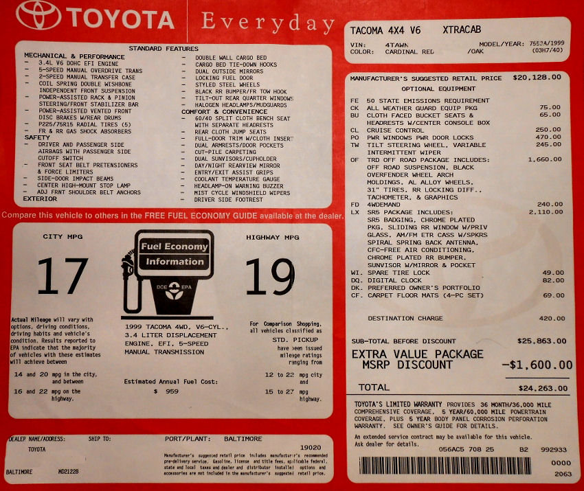

    Pretensioners? Yes, at least on the 99 extracab.
    Owners manual talks about precautions due to the "explosive" properties and "smoke" when they go off.
    Read the left side "Standard Features" > "Safety"
