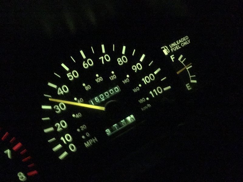

    IMG_1214.jpg This happen today 150k miles.

    Just getting broke inn.

    And you did not let down, with a turnover pic while driving :thumbsup:
