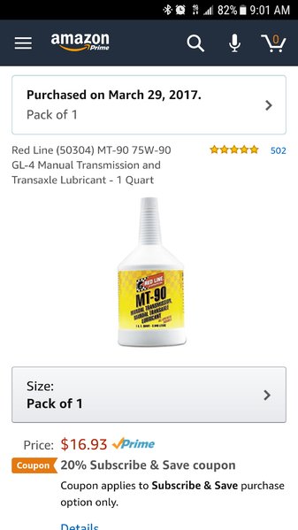

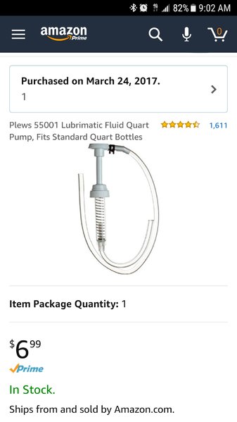

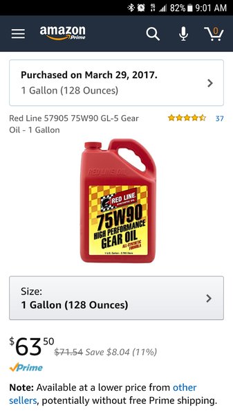

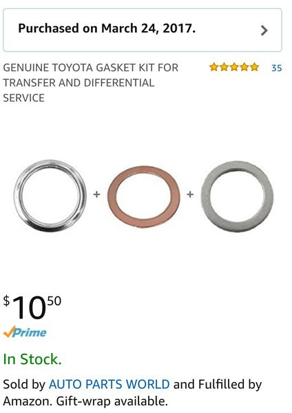

    Been wanting to change my rear diff fluid for months, and just got around to attempting to do it, but for the life of me I just cannot get the stupid drain plug off. It's almost as if it was welded in. What weight fluid should I be going after?
  12. Apr 19, 2017 at 7:07 AM
    TacoSauce04
    TacoSauce04 Well-Known Member
    Mar 15, 2017
    #213375
    448
    David
    2004 Lunar Mist SR5 TRD Double Cab 4x4 Tow Package
    ARE Shell
    This is what i used when i changed mine. I used the entire gal for front and rear diff plus transfer case, plus 1 or so of the x2 single quart bottles.
    The pump is a must and the washers are recommended. Fast and easy job if you can get the bolts off.
    jgill21 likes this.
