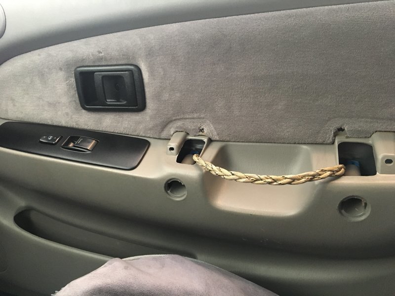

    Just finished up my manual door to power door retrofit.
    The right hand door panel were so beat up (since the donor truck sustained the most damage to the A pillar and pass. side in the rollover) The panel needed a lot of work. I ended up needing to bend the weatherstripping back into shape + screwing it back into the old plastic welds with micro screws, replacing the door handle, but the armrest was beyond repair.
    Toyota wants $75 for a new armrest!
    That was outrageous so until I find a new door panel I braided some paracord I had laying around the garage to make a makeshift handle.

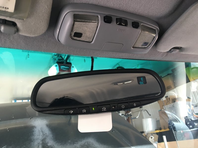

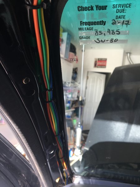

    Just finished wiring up my Gentex 313 mirror with auto dim, HomeLink, Outside Temperature, and Compass. Ran the wiring through the A pillar and down behind the integration module.
    Anyone know where I should mount the ambient temperature sensor? On most cars it's on the front radiator support dead center but I was thinking of mounting it under the radiator behind the license plate. Any thoughts?

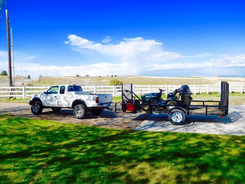

    Cause lawn mowers way a bunch,
    Let me put a picture up of what the bed looks like right bow.

    That trailer and lawn mower would sag the shit out of my dakars with aal...

    What springs are they?

    Alcans

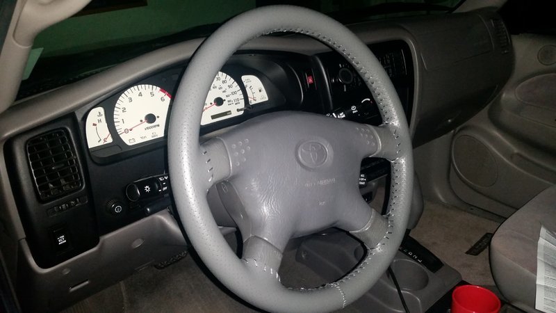

    I mounted mine behind and kinda below the drivers marker light. There is already a few holes there that the sensor snaps into nicely. Makes for a nice tidy wire run too.

    Did your mirror come with the sensor? My mirror is having some trouble reading correctly. I went to pick-n-pull and took the ambient temp. sensors off a full sized Ford SUV, and a GM sedan. When I try both of them it gives me inaccurate readings (the most common one is it flashing "-40" and "ICE", and I live in California where it never gets that cold - it was like 75 degrees outside).
    I think it's something about impedance? The mirror came off a 2011 Nissan Titan so hopefully a random Nissan sedan (or whatever they have at pick-n-pull) would have a sensor that worked.

    Mine does read correctly, I pulled a few different temp probes at the time so I would have a spare. I got everything from GMC Yukons I think. Also isn't there a calibration process? I know there is for the compass, but I don't remember if I had to setup the temp or not as well.
