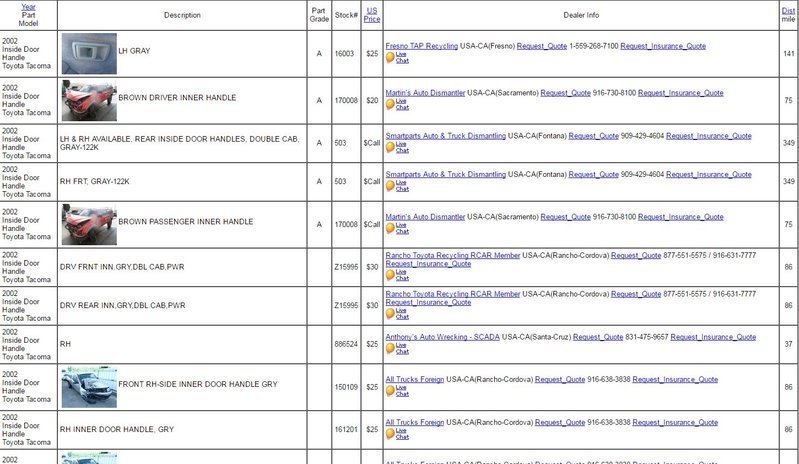

    Yes! In gray! If you come across the interior gray door handle too that'd be really great.
    I don't think you're gonna find a Tacoma here in Cali though... I only see them pop up at pick-n-pull a couple times a year. There's only like 2 registered in the whole pick-n-pull database for the entire state.

    Maybe not pick and pulls but there are door handles in California junk yards
    Edit: the one pic is the door handle not the grab handle, but is they have doors they should have the grab handle too

    I need the armrest actually! I called a bunch of those scrappers on the list and only one of them were willing to sell it separately... for $35. What website is that?

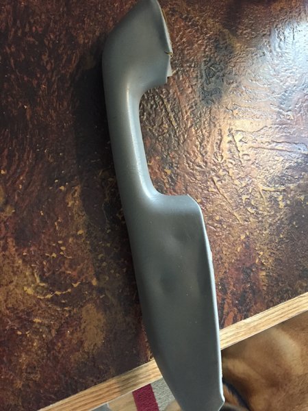

    @BartMaster1234
    You can have this just pay shipping
    Passenger side
    Note the dimples
