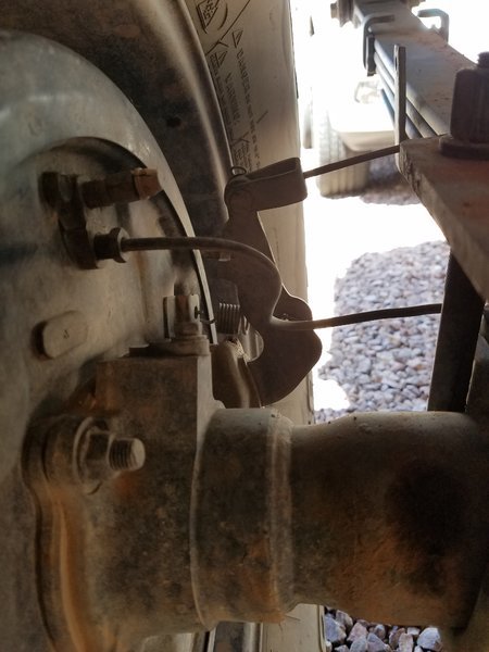

    How does one tell if their rear axle has abs brakes or not besides pulling the axle shafts?
    2001 tacoma prerunner with e locker for reference.

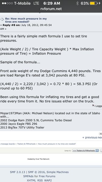

    Air up E tires with 50psi front and 52 rear, feels peppy and improve MPG (245/75/r16 keller ) got to share this

    should be able to tell by looking at the ends of the tubes on the axle housing where they bolt to the backing plates, non abs is just a simple flat flange, abs should have a thicker piece that houses the ring and sensor and such,
    assuming nothing else is modified, if the abs is actually functional and connected, could depend on other factors and any modifications made, whether that axle was stock to that vehicle, etc. (could potentially have non-abs junk running in an abs axle housing if mods have been made)

    A picture of mine. Assuming the bolt on top of the cap for the sensor right.

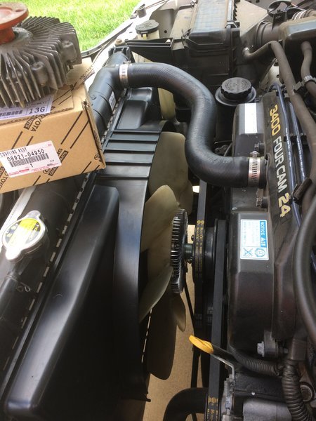

    I got my green fan clutch installed, admittedly took much longer than it should have but gave me an excuse to get some Gear Wrenches.
    Found out while doing this that not only am I missing the lower half of my fan shroud but also my second skid plate has mysteriously gone missing. I took it to the stealership in December for a timing belt/water pump/valve cover gasket replacement and then took it to an exhaust shop last month to price header installation where it was up on a lift. One of those places has it...

    Correct, that's an abs axle housing

    Can't you raise the hood and look at the ABS module? If you have lines going to the back, you have ABS.

    When I added a proportioning valve, I removed all the lines going to the back except one. I know I have the module from the front (which no longer works with the axle I have) but the rear does not stop like it has abs. Just skids so wanted to be sure.

    I can't find an actual photo from the back side but if you have ABS in the rear then you would have a sensor back there too. Besides brake lines and parking brake cable are there any wires connected to the backing plate?

    No just the parking brake cable and the brake line. No electrical lines.
