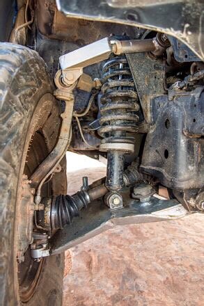

    Be nice if it was 1500..but it won't be. The UCA and LCA alone will be worth that or more. Add steering extensions, brake lines, and CV shafts. I still think it'll cost just as much as a 3.5'' kit. 2000-2400

    If I remember right you won't have to buy new shocks.

    Just a prototype but I agree. that lower arm looks janky

    yeah you can use stock shocks.
    But you won't see massive benefit for going faster without a better shock and valved correctly.
    That and you can get more travel from an extended travel coilover.

    Janky? How?
    Its built to clear rocks so it isn't a normal LCA by any means.
    really the whole kit is a 4wd spindle lift.

    Janky is the wrong word. I really was thinking just unfinished. Its just a prototype so I imagine the final product will look more fit and finished

    Still stuck with a factory length coilover, thus any additional travel you would get would just be because it's wider. Also increase leverage ratio on the shock being it's further away from the spindle. Curious how that plays out with valving and spring rates. I don't see the merits of this kit at all.

    more travel but youd need to up the spring rate and valving for sure.

    Obviously, we need more info, but I don't think the increase in travel/performance would be worth the cost. Get a 3.5" kit or stick with midtravel. 2nd gen +2 kits use a 8" coilover like the wider kits.
