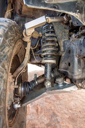

    I am a little confused by what I am seeing.
    Is this a stock spindle with a side-facing unibal mounted where the upper bj would normally be? Are those the stock bump stops?
    I can't tell from the pic what is in place of the lower bj. Is it a ball joint or is it something else?

    Looks like the upper BJ is replaced with a horizontal heim joint, and the lower balljoint appears unchanged, just going into big steel sleeve on the bottom that looks different than stock. I can't even begin to imagine how they maintain rigidity in this design. Also the loss of uptravel due to the bend in the arm will likely be noticed. It's like @Blackdawg said, it is like a 4x4 spindle lift. Cheesy if you ask me, but I suppose experimentation is fine, just hope they can make something more convincing than this for their next model.

    What is going on with that LCA? The center of the front has that divet which must result in one hell of a stress concentration.

    My goodness the more I look at that the more it offends me.

    It's a pretty lousy initial mock-up for sure, we shall see what their second attempt or final comes out to be soon enough.

    Ah it's just a mockup, I was under the impression someone was selling this as a final product.

    Its a horizontal Uniball on the spindle. LBJ is stock. He has the stock bumps rasied up a bit as he is running 37'' tires on his 4runner with this kit. Thus limited the up travel to keep the tire from eating the fender.
    It is a spindle lift. Look at the CV angle, it's like its at full droop at ride hight.
    The Upper Unibal is under the UCA. so its like a 1-1.5'' spindle lift.
    That said, i don't think you'll loose up travel at all. In fact, i think that is where you gain some travel. It would be down travel id be worried about with the CV axle binding.
    Granted you could grind out the cup like we do to tundra axles on 3.5'' LT kits to help prevent that.
    When our stock UCA and LCA bump out, the CV has lots of room to go up. So i can see how this would merit you some more travel from the gained up travel.

    I'd have to see it move to determine if there is still the potential for all the uptravel. But I think this would just stuff the UCA into the inner fender and leave you with a permanent uncomfortably tall ride height.
