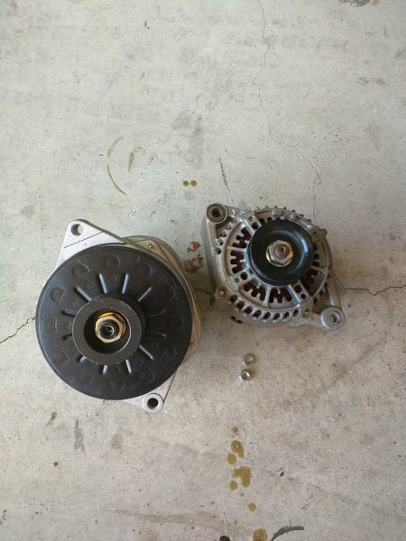

    Finally did the alt swap today. :bananadance: used the adapter pigtail from eBay. Now I need to do the wiring upgrade... Thanks again @Blackdawg . And it had the smaller pulley so the same belt worked :thumbsup:

    Plz tell me more? Whats the deal with this monster of an alternator?

    Gm alternator swap. Output is 140 amps compared to stock 80. Moar power! Nice for running extra lights, stereo, etc or just moar power...

    Jim carey voice. Rah ha ha ha ha eallyy??? Lol how do I get one? Specific year GM/ model? Is there a write up on here?

    @Blackdawg had all the answers for me. Advanced auto alternator, eBay pig tail adapter are the basic quick two components (and spacer washers) I did to get it running again since mine was dead. For the battery connection to the alternator, if you don't do new wiring, the lug needs to be bored out a bit to clear the new connection point. Quick dremel work got it on there. oh, and a spacer of sorts as mentioned. Read up on the link in blackdawgs frankenstein build link. Great info and pictures.

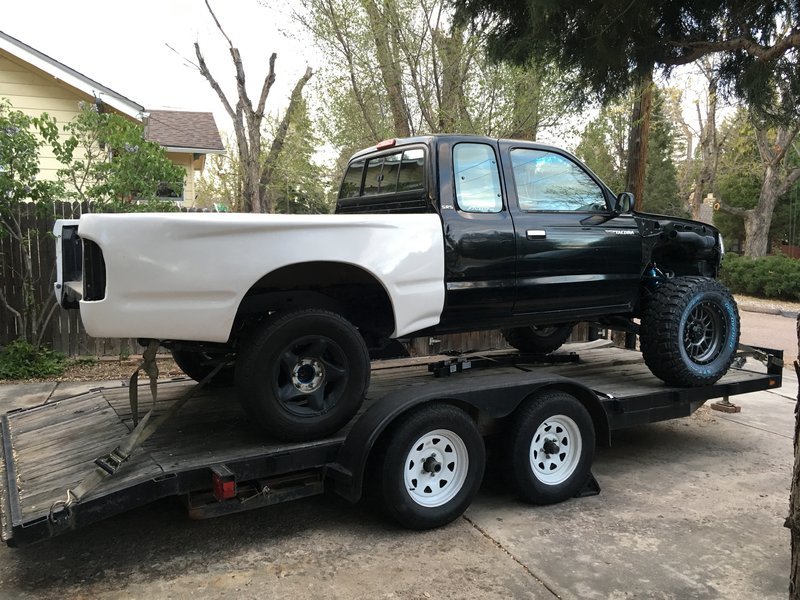

    Bed back on today and gathered up all the parts to prep for welding.
