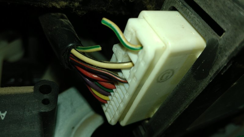

    Goodbye DTRL's!!! Cut the wire today. Yay!!!! Lol
