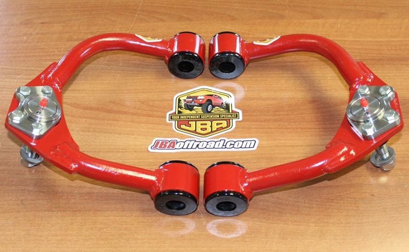

    wait...

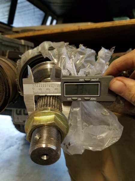

    That napa CV looks like an ADD CV..is it? The splines count looks more..Or is that your point haha
    :rofl:

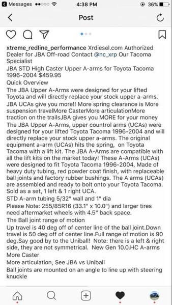

    Looks like they made a uniball adapter for LR UCAs and called them their own??

    Pretty sure they still use a normal balljoint like their second gen Ucas.
    I saw a post on Facebook and they're selling them for like 480ish I think.
  13. May 4, 2017 at 10:15 AM
    JKO1998
    JKO1998 Well-Known Member
    Jun 2, 2015
    #156578
    53,132
    Utah
    460*

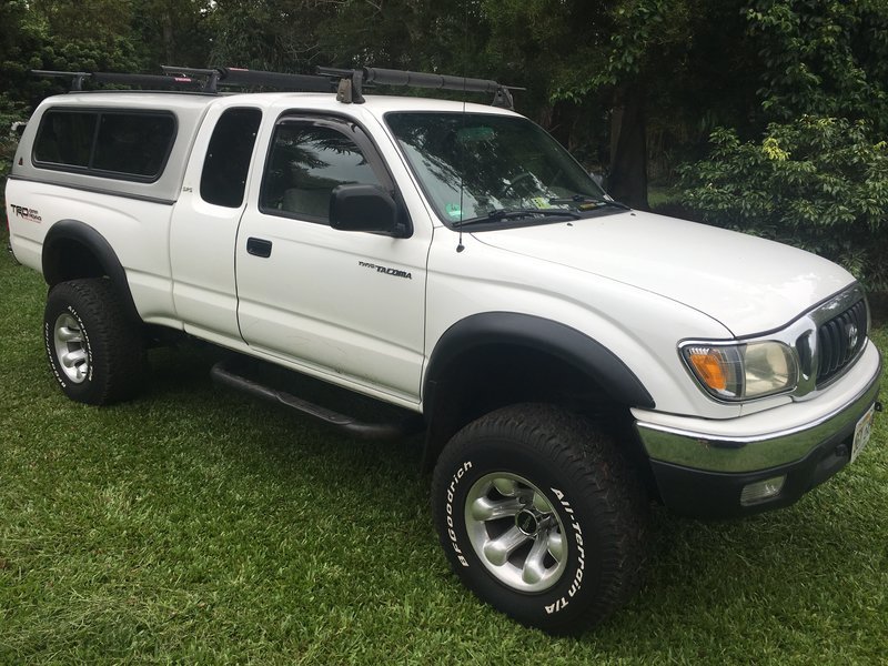

    She got a camper and racks today!
    Next is to install the bilistein 5100 coilovers up front.

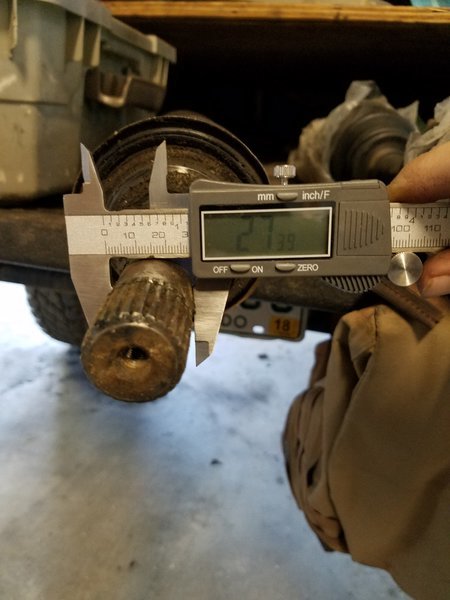

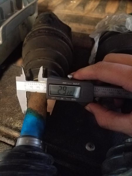

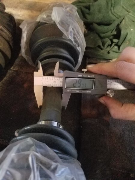

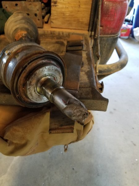

    It is a ADD axle. Just comparing the two. The main shaft diameters are the same. It's the hub end that differs. There seemed to be some confusion about the main axle being different but it's the same.
    From looking at the two side by side I can understand if the weak part of the axle is the hub end instead of the cage on a manual cv. I'll give it another go and if the next breakage blows the hub up I'll probably go back to ADD and just deal with my driveshaft spinning all the time.

    I'm glad you posted those pics.
    From the pic you posted in another thread of the rock situation that caused the breakage, it wouldn't have mattered if it had been manual or ADD. That particular situation with the entire weight of the truck on a single tire, and the steering tire at that, plus the attempt at reverse... would have broke a Dana 44 exactly the same way.
    It's very common for a front stub shaft to break when torque is applied in reverse in that very situation, front axle assemblies are just not as stout as the rear.

    Id be curious what it looks like under the outer boot. I swear the manual CVs i have seen taper a bit.
    But i went back a looked at the photo after posting my last replay and saw the nut lol
    But big spline count difference for sure on the manuals vs ADD as you can see!

    FROR supposedly had a 35 spline kit for the IFS. I'm not sure if it fits the 1st gens.
    I've seen their 4runner all over town though, thing looks totally badass. Might be something to look into.
    35 spline axles will handle 37" tires with no trouble. I've tried like hell to break my custom Dana 60. I've shattered the 30 spline Dana 44 several times though. However, it was just fine on 35's. The addition of 37's toasted it time and time again.
    I just checked a spare 44 stub shaft, it's diameter at the stub is only 28.05mm, so actually similar to the manual stub you broke.
    Edited that last bit, I thought your pic showed a slightly larger diameter.
