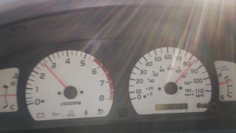

    Damn. How do i fix the speedo. Its way off. No way im doing near 90 traveling with traffic

    the good knews is, you stayed on 4.88s and 33s! So you can buy a speedo gear to swap out the OEM one and with your gears, tires/tranny combo. It should put it back very close(unlike 5.29s and 35s..)
    I don't remember the correct one..BUT! I haz friends that have..
    @Squeaky Penguin @Digiratus Both have 4.88s but different trannies. They can give you the PN to the right one.

    Regear? How's that power feel?
    IIRC, its the 33 tooth gear, the highest tooth count available. I have a part number at home. It got me very close. 72 indicated for 70 gps.
    edit: Part number for the 33 tooth speedo gear is 33403-39415

    Weird... we traveled that speed with about 2800 rpm.... let us know the outcome of this error

    This is due to regearing.
    Just putting on larger tires changes your speed vs indicated.

    Lovin it. Engine sounds like sex. Alot more responsive. I then got carried away and went and bought new tires and an alignment. Shes ready. Just did my 100 mile break in. 400 to go and then i can really play
    Thanks for the part number. How hard to swap that out

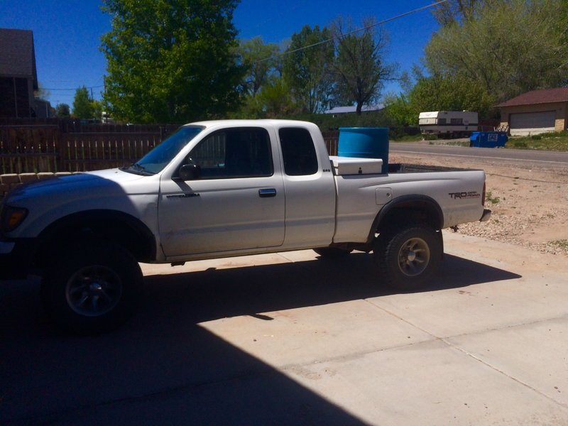

    50 gallon thing of water, so like 450-60 pounds.
    Hub to fender was 24" empty, full it's 23ish.
    DECENT

    @Fernando
    I remember it being pretty easy. You just remove a small cover and slide out the old and slide in the new. Its right on the end of the output shaft on the t-case. Here is a pic.
    This a a 2nd gen thread but it should apply for the most part.
    https://www.tacomaworld.com/threads/speedometer-and-odometer-error-corrected-easily.293134/
