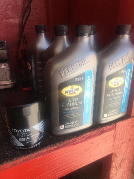

    Just change the oil, tried out some 0W-40 this time around.

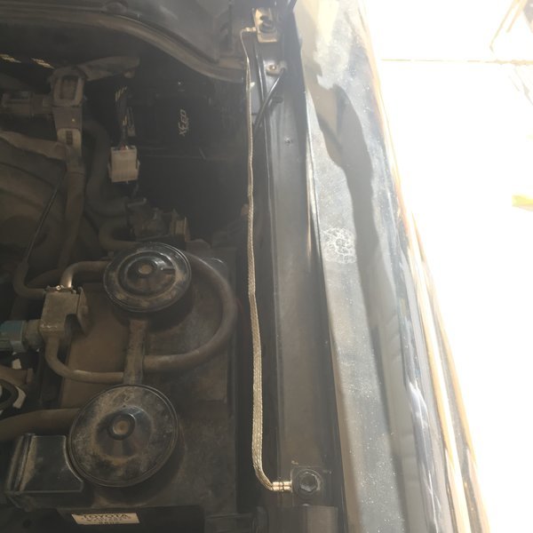

    It's not really about the length (que @Madjik_Man ), it's more about the location and the chassis ground. The hood location give you a decent ground plane to work with. Roof is the best but hood is a reasonable compromise.
    Marc @SconnieHailer is running a 2 footer as well and has made his work very well as I recall.

    I figured as much, I have proper ground strap weaving and such. I'll save the roof for the ham.

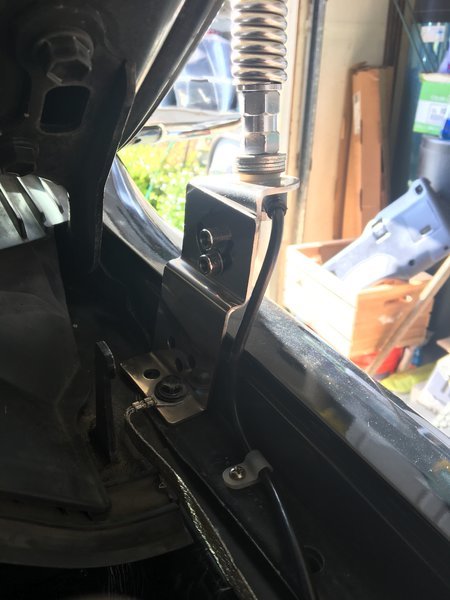

    Anyone good at CB wiring and tuning? I have my Midland CB hooked up and sometimes it works (I can hear clear conversations sometimes, rarely though) but most of the time nothing.
    I have a super high SWR reading (above 4) so I'm guessing there's a fault in my antenna.
    I thought it was an improper ground, so I added a grounding strap. Didn't do anything.
    I'm guessing I assembled the antenna stud wrong. Any ideas?

    sounds like your antenna isn't tuned if you have an SWR above 4. Needs to be adjusted. What kind of antenna?

    To me it sounds like a grounding issue. Do you have close up pic of the way the antenna is attached to the hood mount? One that shows the various components of the antenna base the spacers and the coax cable attachment.
    Do not keep broadcasting at an SWR of 4. It will burn out the finals in the radio, if it hasn't already.

    Needs to be put on like so depending on connection type.

    Let me get some pics for you. I have a strong suspicion it's the antenna mounting since I didn't use the included hardware with the antenna, the washers and lock washer they provided didn't fit the antenna right so I went out and bought some washers that fit.
