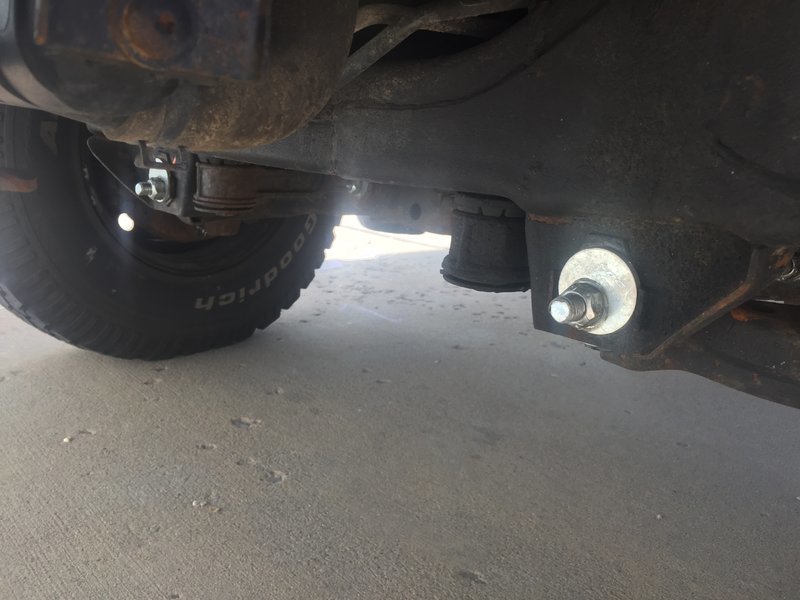

    Spring under :bananadance:
    More pics in my build thread. :D

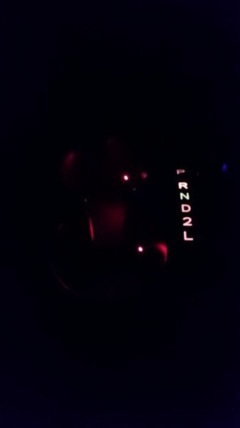

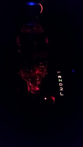

    Used up some extra LEDs i had laying around.20170507_213157.jpg 20170507_213118.jpg

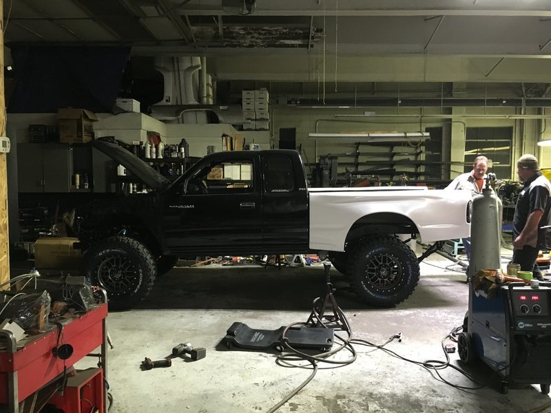

    so what you just let the boys do all the work while you watch and take pics? :p

    what?! you didn't do the welding yourself?! :boink:
