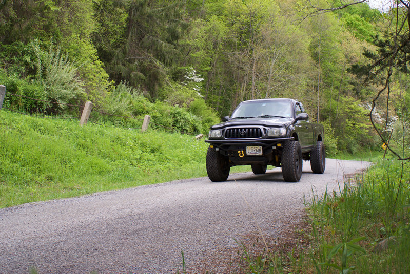

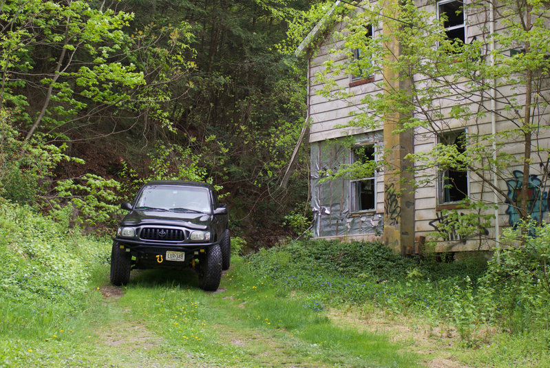

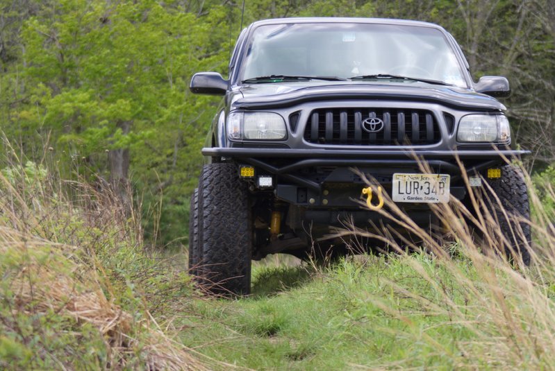

    2001 tacoma sr5 4x4
    OME 3" lift 881 coils, Dakar's 33" General Grabber AT2's TG low profile front bumper
    from yesterday
