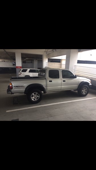

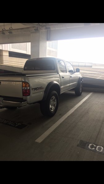

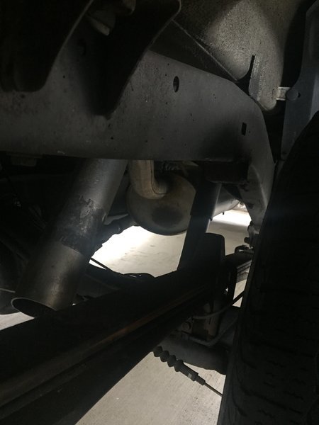

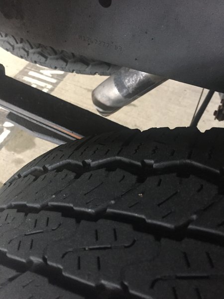

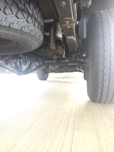

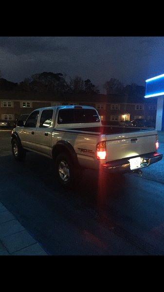

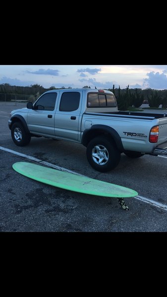

    All of the trucks are looking good! Been loving my truck I bought in February. Small mods include tint with 18% SunTek Carbon front driver and passenger doors and same film on the rear doors and back glass over stock tint, and did a 5% strip on the windshield. Great visibility, not too dark at night. I also installed a black shorty antenna. I recently removed the mudflaps (which I kept in storage) and installed LED license plate lights. I also chopped the tailpipe at the bend which made it dump over the rear axle for a nice hidden look and increased rear clearance. I also sprayed the rear axle with semi-flat black to get it looking new again, I really recommend using semi-flat or semi-satin for undercarriage touch-ups it looks perfect for the task in my opinion. Stoked on this thing, especially with how well it does on the beach!

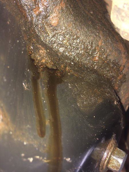

    Need some help, found the oil leak, how would I fix this? jb weld? Is it possible to weld it somehow? kinda afraid to pick at it or anything before knowing how to fix it.

    That looks like it's been seeping from higher up for a long time. Possibly the rear main seal.

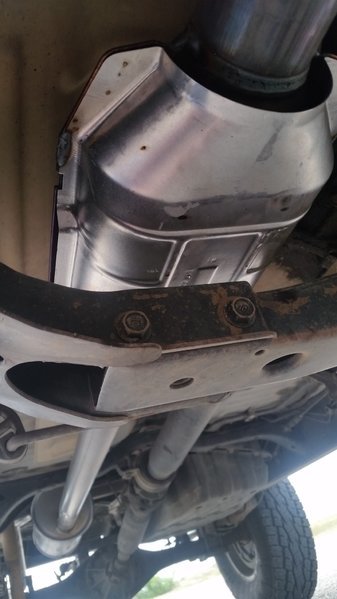

    Installed new OEM style exhaust, premium load cat both from Bosal and Denso O2 sensors. tmp_17039-20170510_123030-720134814.jpg

    all around the pan is clean theres a very very minor leak on the passenger side by the pan gasket but it isn't reaching the bottom. Im not sure what you mean by the rear main seal?

    The rear main seal is what the crank shaft spins in. The oil pan helps seal it as well. Used to go out in 22re's every 200k. haha

    Ohh I see, there is a very small amount of oil coming out near the front main but the back is totally dry. I ordered a pan gasket thinking it was leaking around the pan originally then I cleaned everything up again and found that rust spot.

    I'd never use a cork gasket the. FIPG is the way to go. Toyota makes great FIPG.
