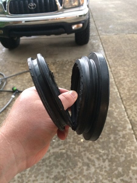

    I did a little redneck engineering today.
    I was missing the seal around the air duct into the air box for the used Volant CAI I purchased. Emailed Volant last week to see about ordering their 14.5" trim with rubber sponge. No response. So I went to Ferguson plumbing supply and bought an $8.60 donut shaped compression seal, item code PFSVQTGM:

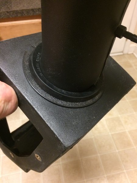

    I cut it off right after the first ring, took 100 grit sandpaper to the inside of it and hand spun it on the paper until I could just barely get it around the air duct tube:
    The air box opening fits right between the two rings, tight. The air tube with the gasket pushes tight against the box opening:

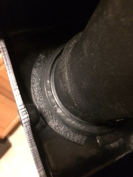

    Inside air box:
