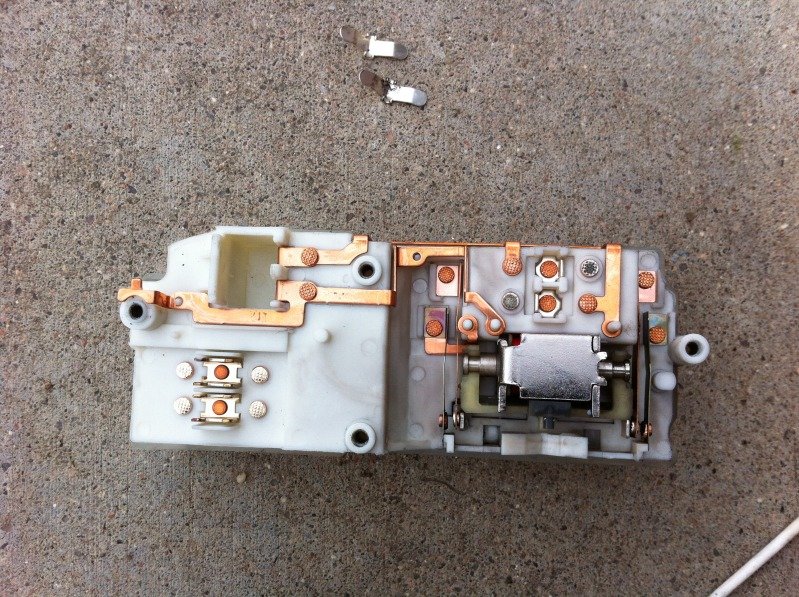

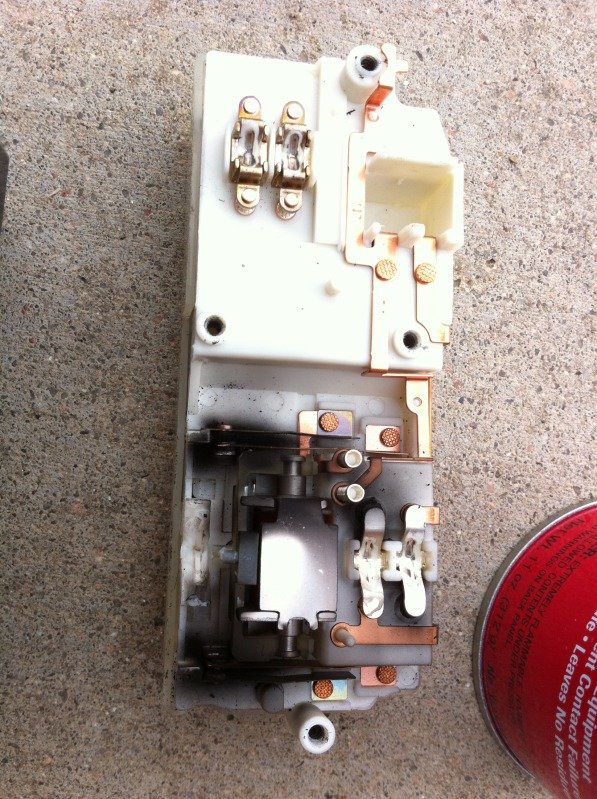

    All that black stuff is carbon build up from 20 years of use. Eventually it makes it shoddy/impossible for the switch to make contact and engage the circuit.
    The area where yours (and mine below) are most built up is the driver's side switch... which makes sense as that's the one that gets the heaviest use.
    Here are my before and after pics.... works like new after cleaning them.

    How long has yours been working since you cleaned it? I'll be snagging some stuff to clean it on the ride home today. Glad it wasn't (for now) anything major that needs to be replaced
