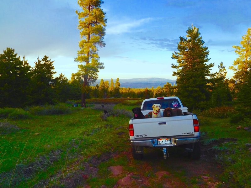

    Went for a drive after work.
    My Kings are starting to make some pretty crazy race truck noises too....

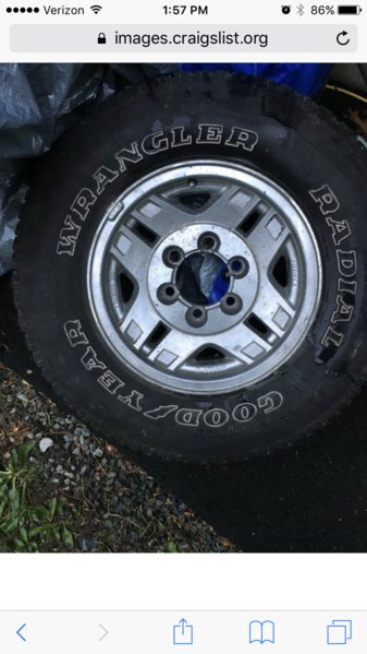

    I ran a set of these on my first Tacoma. My set were from a '93 pre-taco pickup. As somemone mentioned, they are 15x7. Mine were stammped with 15mm on the inside of the wheel. This offset on a 7" wide wheel puts the backspacing at a little over 4.5".
    I am running CVJ axles with Kings and have no clearance issues.

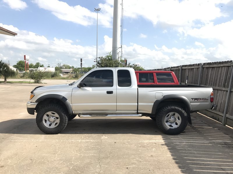

    Here's a pic after the billies were installed. I honestly think the front is a little higher than I would like.

    Thats weird. Not sure what the issue with these was

    That's how mine sits with new billies. Kinda like it. Nice and level.

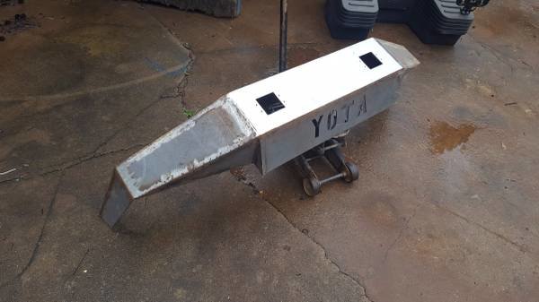

    So there's a possibility of me picking this plate bumper up for a really good deal , but it's made of 3/16 all the way around and I was wondering if y'all had any input on how this would effect my front coils?

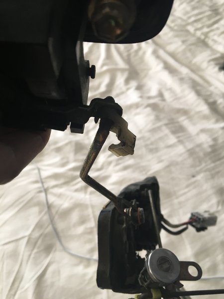

    Im prob too late for you but you pull the rod then the clip should pop out. with the rod in the clip it keeps it tight.
