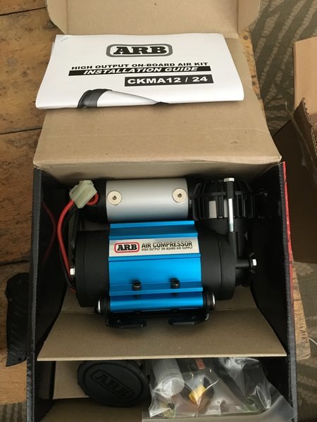

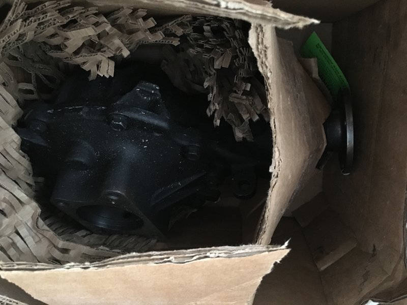

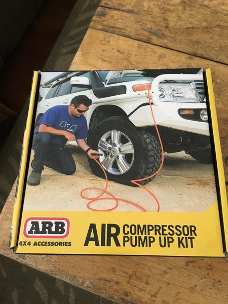

    Well this stuff was just delivered...
    Anyone know a good way to break in front gears with add hubs?
    I've looked online which yields multiple different results..:notsure::popcorn:

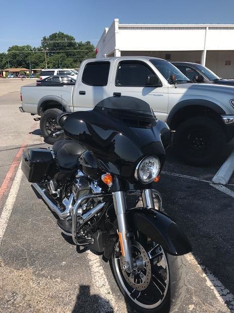

    I didnt do anything to my 01 tacoma but i did however get a garage buddy for it

    I spoke to ECGS on this and they said the front kind of breaks in naturally with the rear. Since the left CV is technically always spinning the ring gear, it's breaking in at the same time as your rear. Even still, I was about to get 40 miles on my front diff in 4 high as well.

    Just because the CV is spinning, doesn't mean the ring gear is spinning. It would just spin the spider gears.
    I did 3 heat cycles on dirt roads in 4wd, changed the oil, and then used 4wd as much as possible for the next several hundred miles. I tossed it in 4wd on any straight section of road, or dirt road.

    Fuck you're right, it's the spiders that spin. Hence why I needed to cut that CV so my spiders wouldn't spin which is what I had busted for a year lol. Brain fart. 3 heat cycles meaning driving for 20 mins and then fully cooling before driving again?

    Heat cycles of 15-20 min each with 20-25 min cool down?
    Ecgs says break in period of 500 miles on their website then gear oil change with no more than driving for 50 miles at a time... this is gonna take a bit
