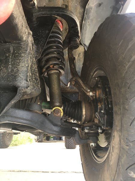

    Finished replacement of lower ball joints, upper ball joints, outer tie rods, lower shock bushings, upper shock bushings, sway bar with new bushings and touched up the frame, installed new 3 piece rat skid and fuel tank skid...

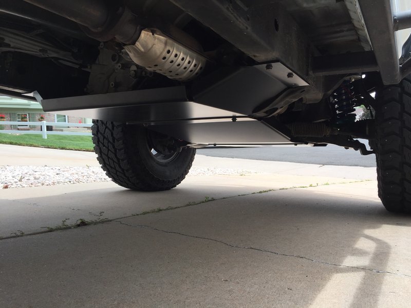

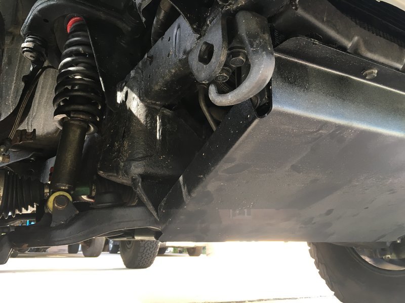

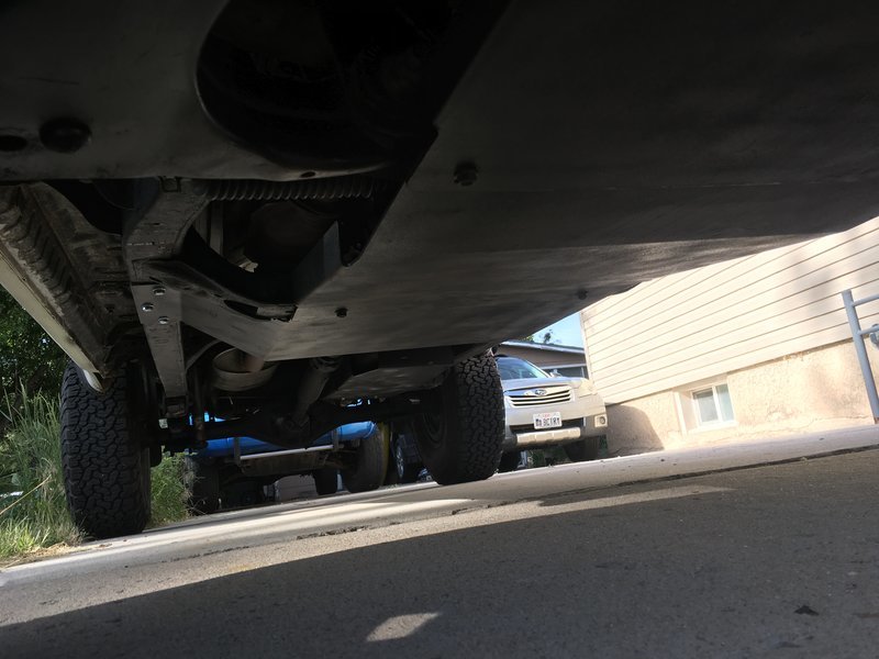

    Me too on the skids, minus the gas tank skid.
    How was the install on that one? Likely gonna get it done tomorrow.

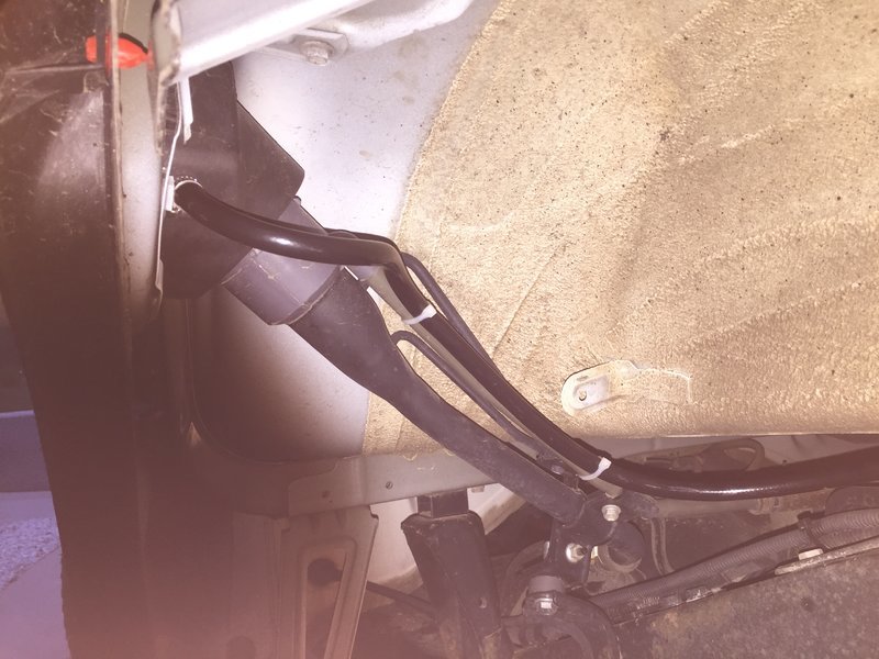

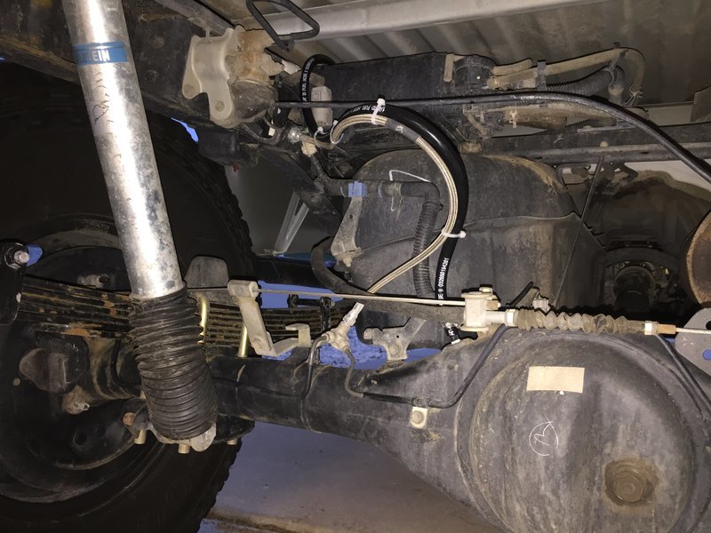

    I also finally knocked out the diff breather relocation mod. Found a dealership that had the union and it took me no time at all.
    Sorry about the sucktastic phone pics...

    My only 2 complaints was if I wasnt on the lift I would have drilled the outside hole directly into my brake lines that line up above the existing hole I. The skid plate... so just double check it... I moved mine 1/4 over to inside re drilled in the plate and all good...I did have to beat out the outside edge with a crescent and a ball pean so it wouldn't rub on two parts of the strap and tank... but really happy with end product. Looks clean
