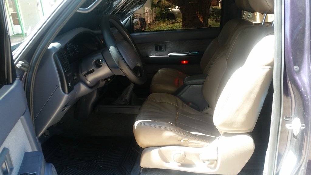

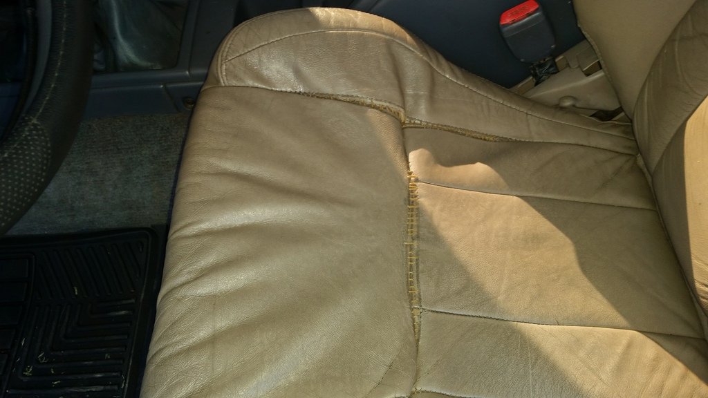

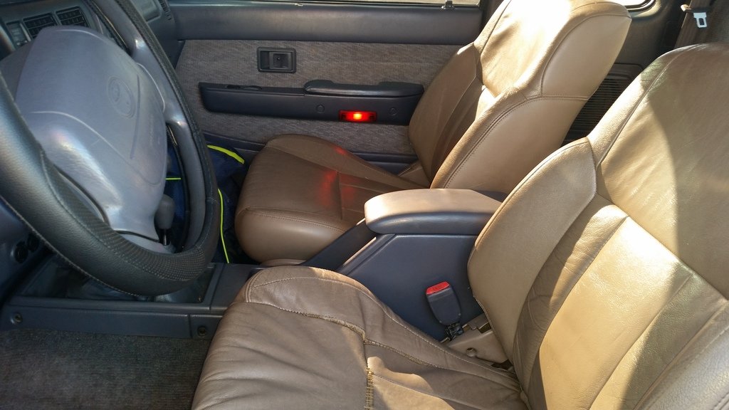

    Fanagled some 4runner leather bucket seats into my 98 yesterday.
    They were $20 on craigslist because the driver side was 'torn'. So I re-sewed it.
    20170619_080404_zps1jjrme32_7b5a39c60b651747051d810aad2ee2d4685c653c.jpg20170618_152955_zps72v3uqel_be2821ca50f5e52978e53c844d388ad7177d758d.jpg[/URL]

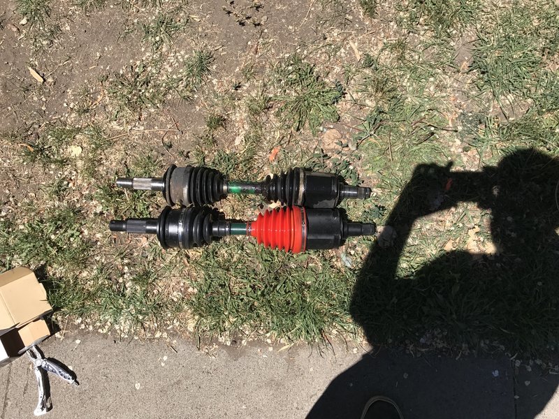

    @Misplaced Nebraskan hows your cvjs holding up?

    Lol thanks. Glad I made someone jealous, that was the whole point ;)
    Oh, and they are comfy, too.

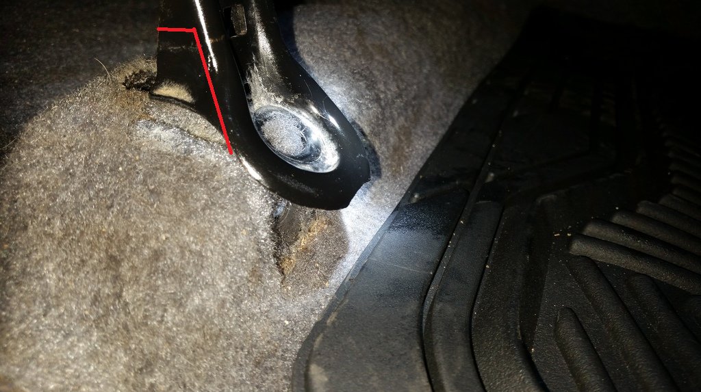

    Did you drill an extra hole or did you modify the bracket?

    Only have a few hundred miles on them so far, but no complaints from shipping, quality or anything. Extended boots look good too.

    The two inner rails closer to the console bolted right up.
    The two on the outer side required the fanagling. The rear one 'almost' lined up, but the original seat had a rubber spacer. So I threw some washers in there and just kinda muscled it til the hole lined up.
    The front one needed a little more... I cut along the red line there and then used a hammer to bend the loop down. Both the passenger and driver side were the exact same, just mirrored.
