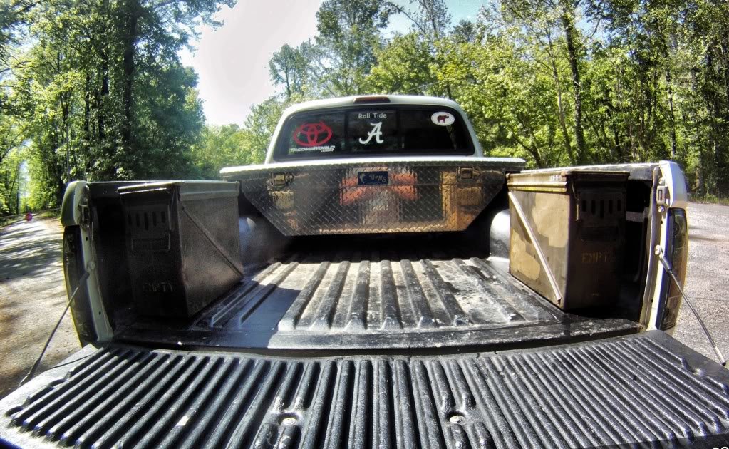

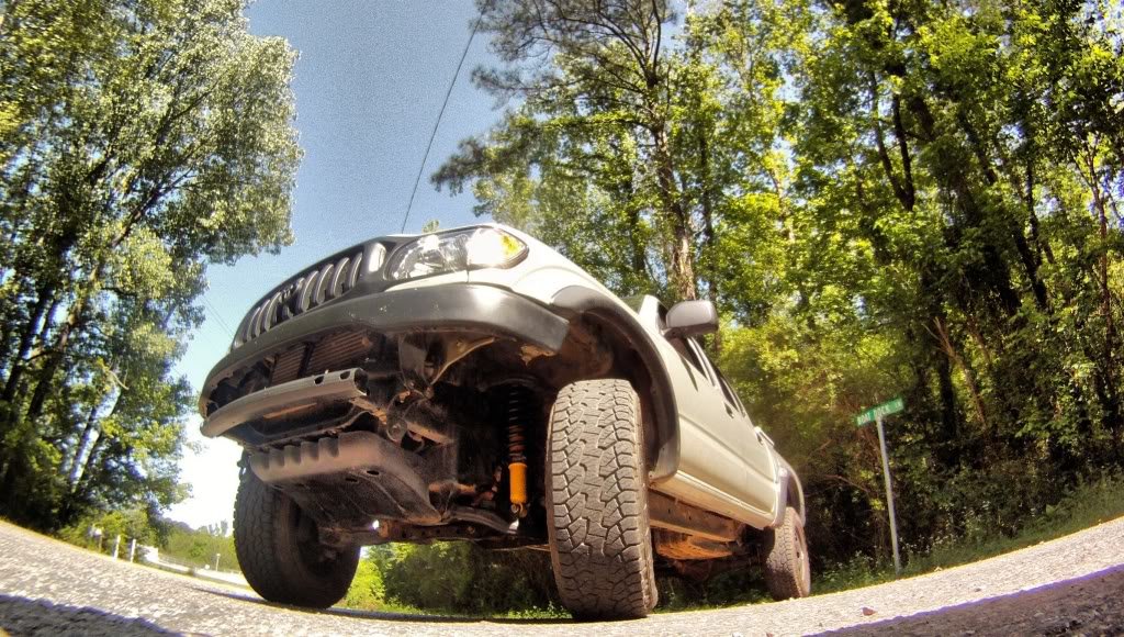

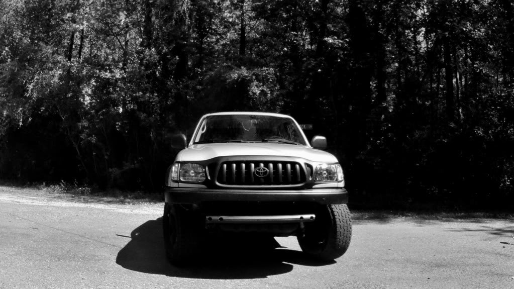

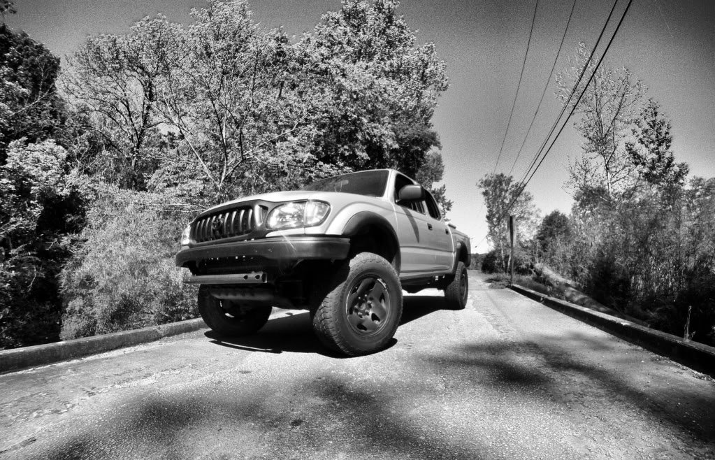

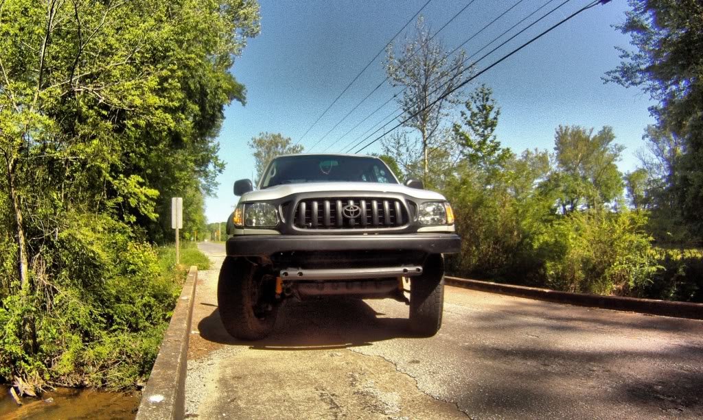

    Took some pictures with the GoPro, Also Pictures of the 20MM Ammo Cans.

    ^^^ looks good man!
    I need to get some of those ammo boxes

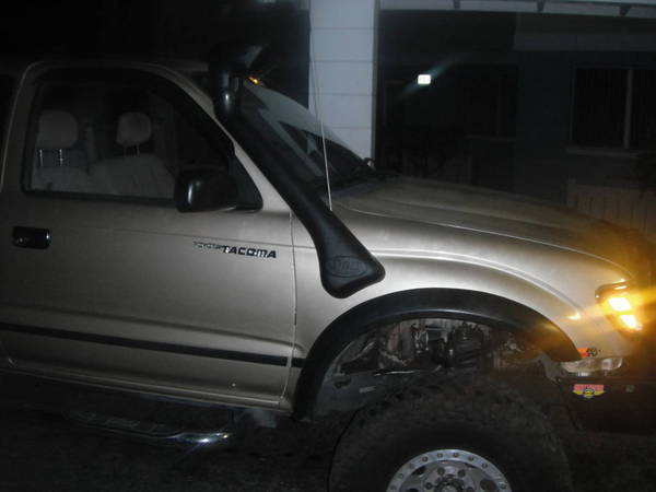

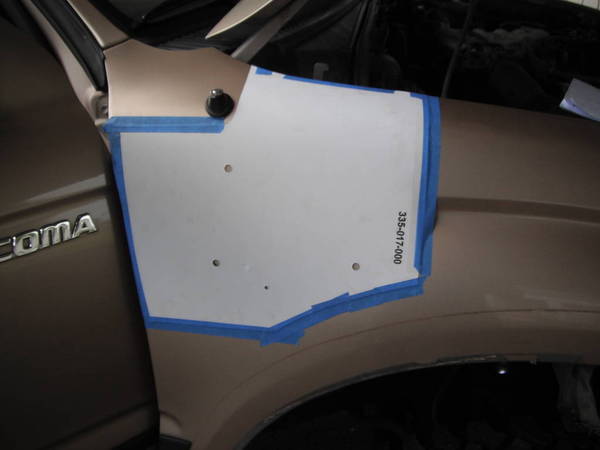

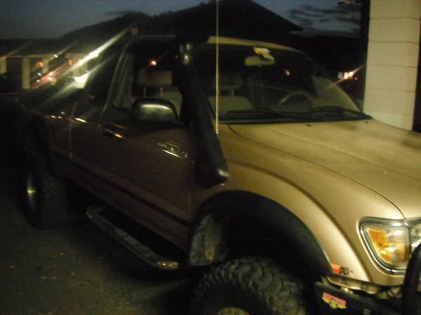

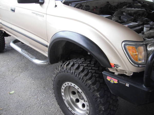

    Put my Snorkel on today
    The before the Chopping up my truck happens.

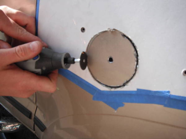

    It came with this. Awesome to have it already lined up, all I had to do was get it flushed with the edges.

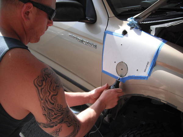

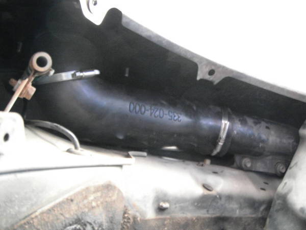

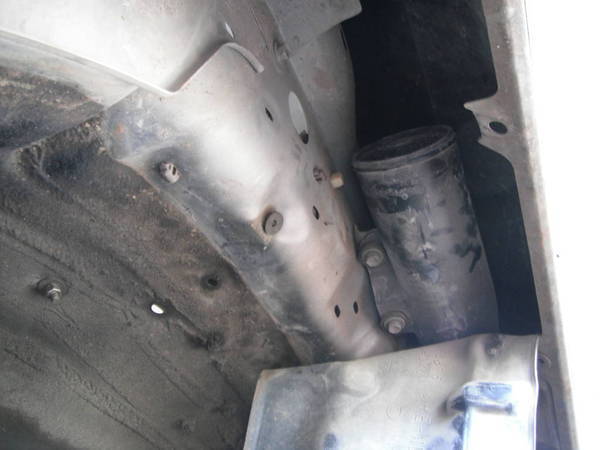

    after pulling back the wheelwell cover. you can see where the intake pipe is.

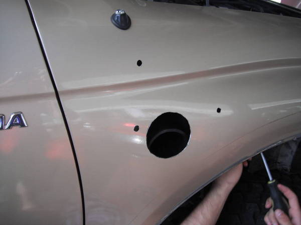

    I would have used a sawhole but my buddies drill craped out on me. so Thank god for that dremel I had buyed.
    After the chop up

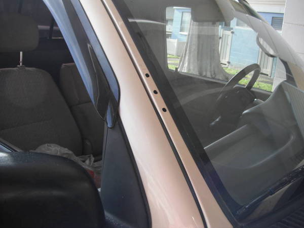

    After the holes in the fender I put on the main snorkel body. Lined up the holes marked them and drilled

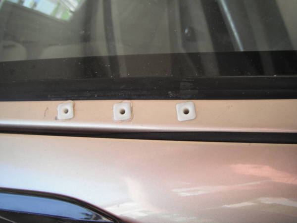

    put the clips in. Made sure it defently stayed so I super glued it in with some multi-weather super glue from home depot.
    Hooked up the extension connector. put the clamps on and tighten it down.
    After a little screw tightning and glue drying and the primer dried. the Final product.

    nice man!!

    x2...looks great.
    I would love a snorkel...but I dont ever do any water crossings and I dont think I would ever have the balls to hack a giant hole in my fender :eek::)
