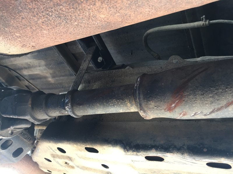

    Good thing I'm bringing a spare drive shaft to Moab huh?

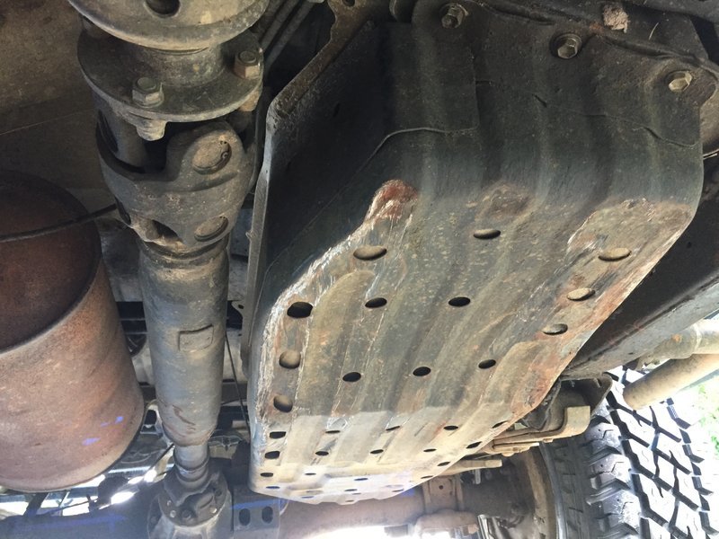

    I like your elocker skid. I still have mine in the box to mount up.
    There is a nice gas tank skid out there. I forget now who makes it. Looking at the way the gas tank hangs in the rear I'm wondering if the heavier skid would really help since it just attaches to the gas tank and not the frame.

    The RAT gas tank skid has the front bolts attach to a cross member. It also doesn't have those cuts on the bottom that could get caught up on something

    My LROR gas tank skid bolts to the crossmember in the front. If you're going to hit your gastank, it's most likely in the front anyways.
    FWIW, I've hit my driveshaft on numerous occasions. It's got a few little dents in it, but nothing too bad. They seem to hold up well. I have broken off the zerk for the slip joint like a dozen times though.

    Nice. Are they still on TW? The one I was thinking of is full of holes which doesn't seem like a good idea.
    Either way the back of the skid just attaches to the tank which hangs from the cross member by a metal strap. It would be nice if there was a way to attach the rear of the skid directly to the cross member unless the tank is meant to rotate or push up in the rear.
    Edit: I guess there is another issue. The cross member that supports the back of the tank and the muffler is not all that strong. I wouldn't really want to support the full weight of a truck high centered on the tank :)

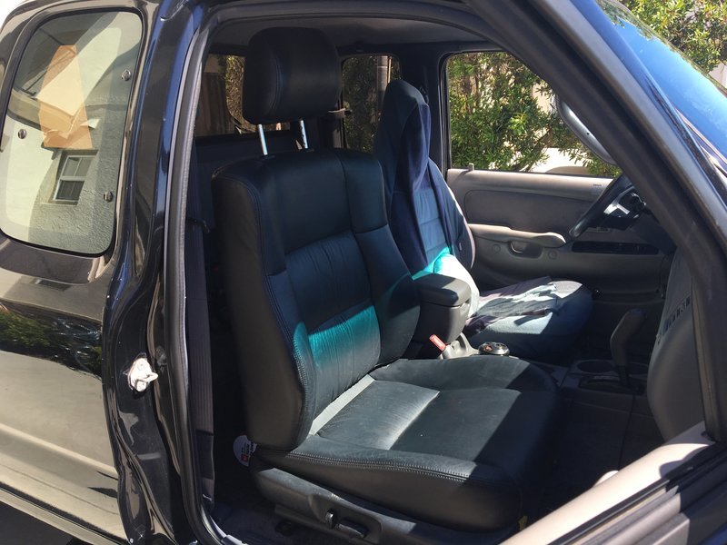

    Lexus ES300 seats are coming along nicely. Trying to figure out how I'm going to weld them to the Tacoma rails, I have the electrical functions worked out for the most part.

    Those look like they sit way higher than the stock seats, or is that just how they're mocked up?
    I would love to do something like this, but if anything I need to move the seat down.

    Nope you're right, they ride super high. This isn't even with the Tacoma seat rails on yet, once I weld them on it will be even higher. The seat does have seat cushion adjustment though. I'm a pretty tall person at 5'11" and it's really not that bad.
