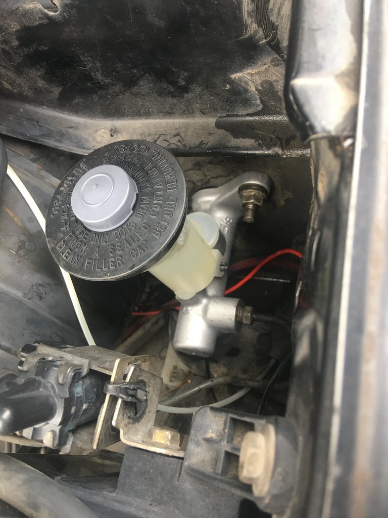

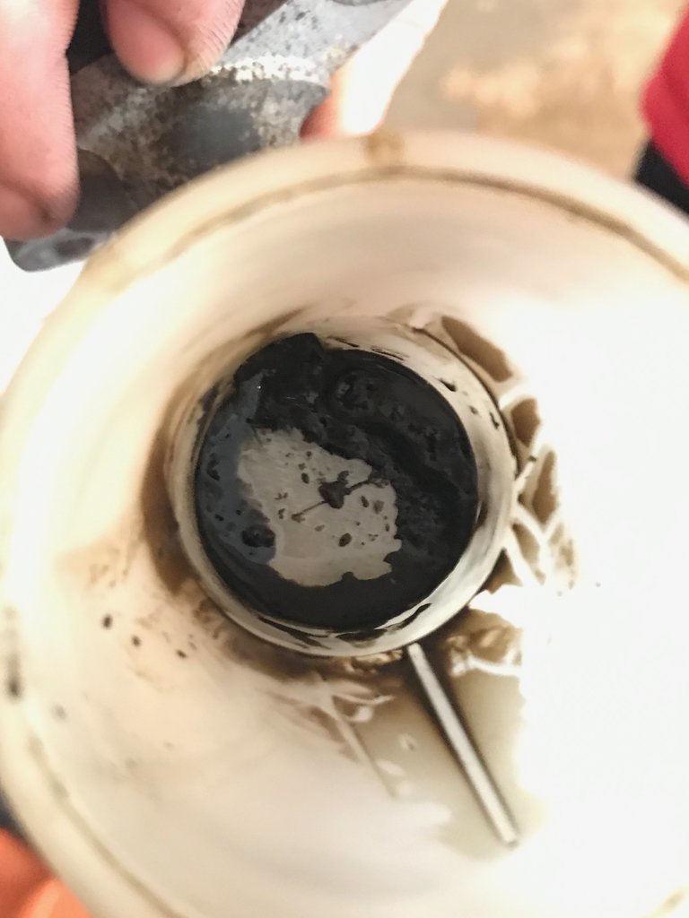

    Changed out my clutch master and slave cylinder with new Aisin parts from Amazon. Clutch feels so much better. No creaking anymore. I think my slave cylinder was creaking. I thought it was the fork so I kept lubing it but it never went away. It's all quiet now. Also noticed my old master cylinder reservoir is like 1.5-2" smaller than the new one. Strange. There was gunk in the bottom of the old reservoir. I went way too long between fluid changes and flush.
    New slave
    Nasty old reservoir.
    Also, has anyone ever adjusted the clutch pedal? I set mine so that the pedal is all the way up at full bump to allow the cotter pin to be inserted. Think this is how it should go..

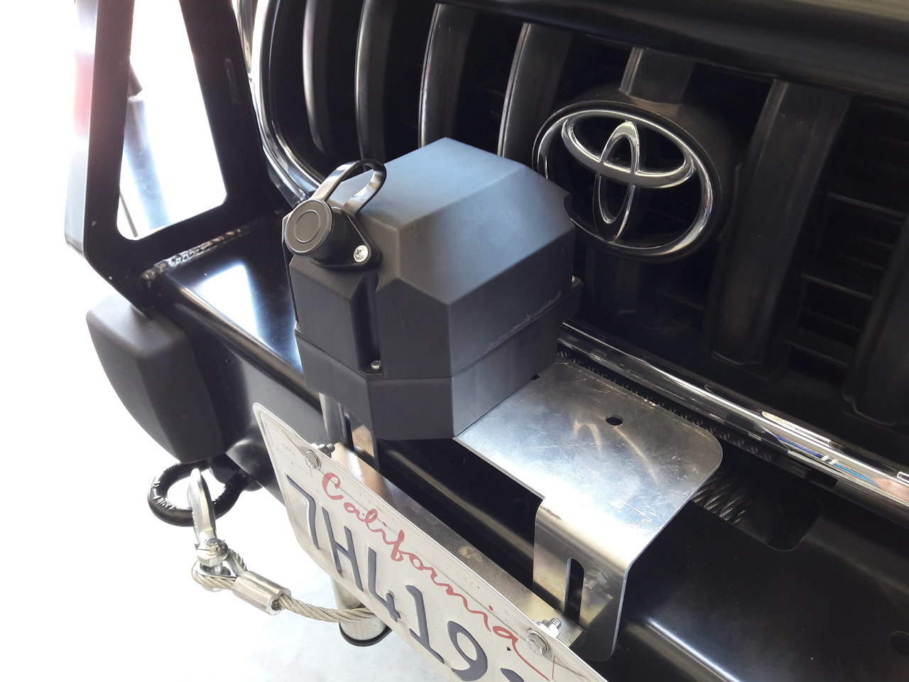

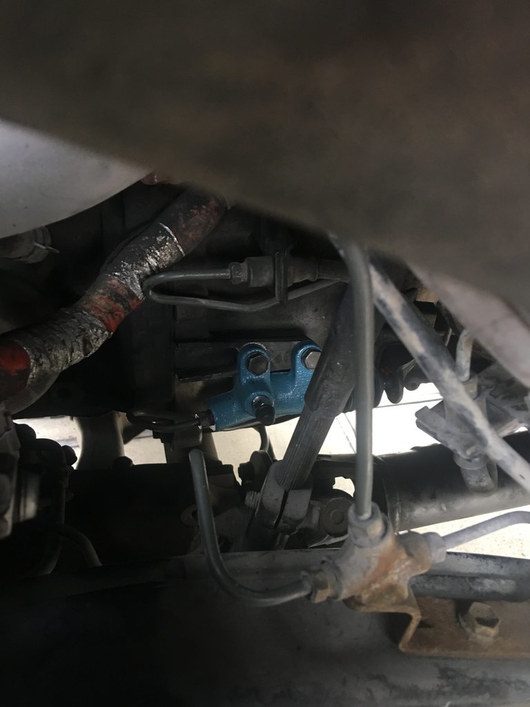

    Relocated my winch solenoid. I lucked out and was able to use this aluminum bracket I picked up for another reason from a local industrial hardware supplier for about $5.
    The slots were the same width as my license plate bolts. Made a template for the screw locations and drilled them out. Worked out great. Now I just need to wire the damn thing up.

    Looks nice, the actual solenoid unit inside that little box is well sealed, mine has been hanging out on the fender without that plastic cover and still works great. How did you deal with the clutch lever?
