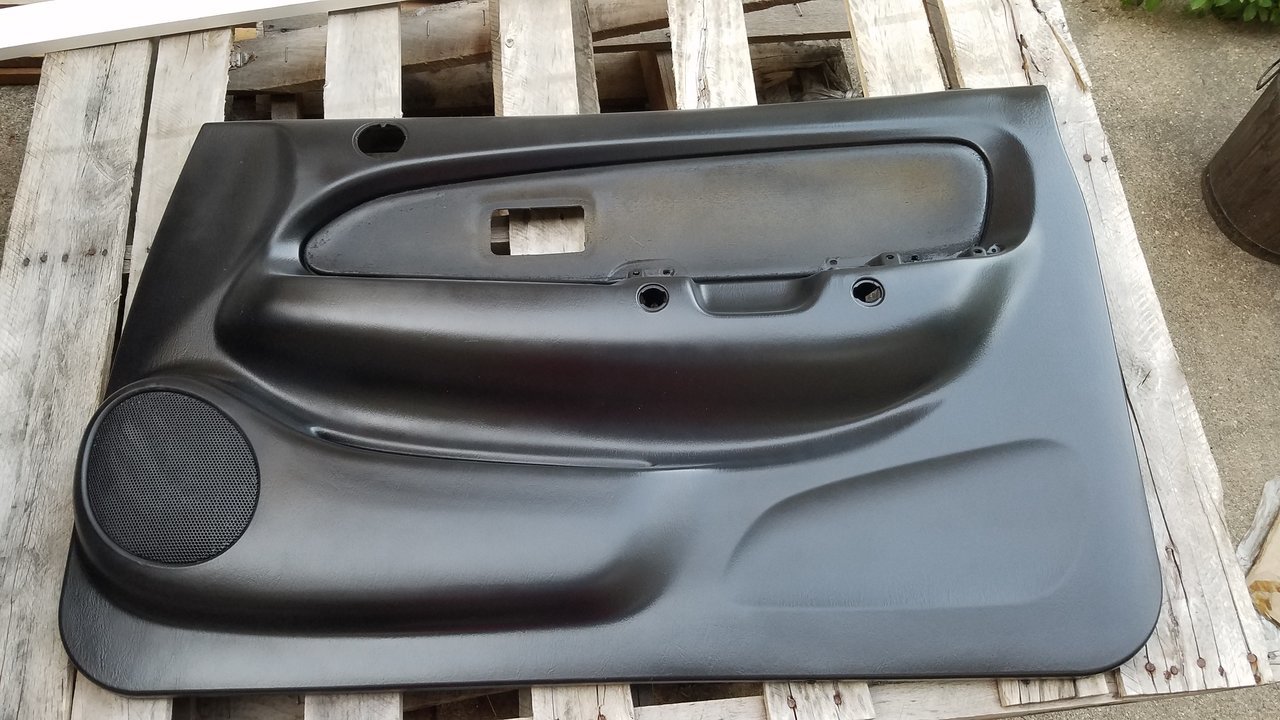

    Blacking out interior, next replacing grey cloth with black leather
