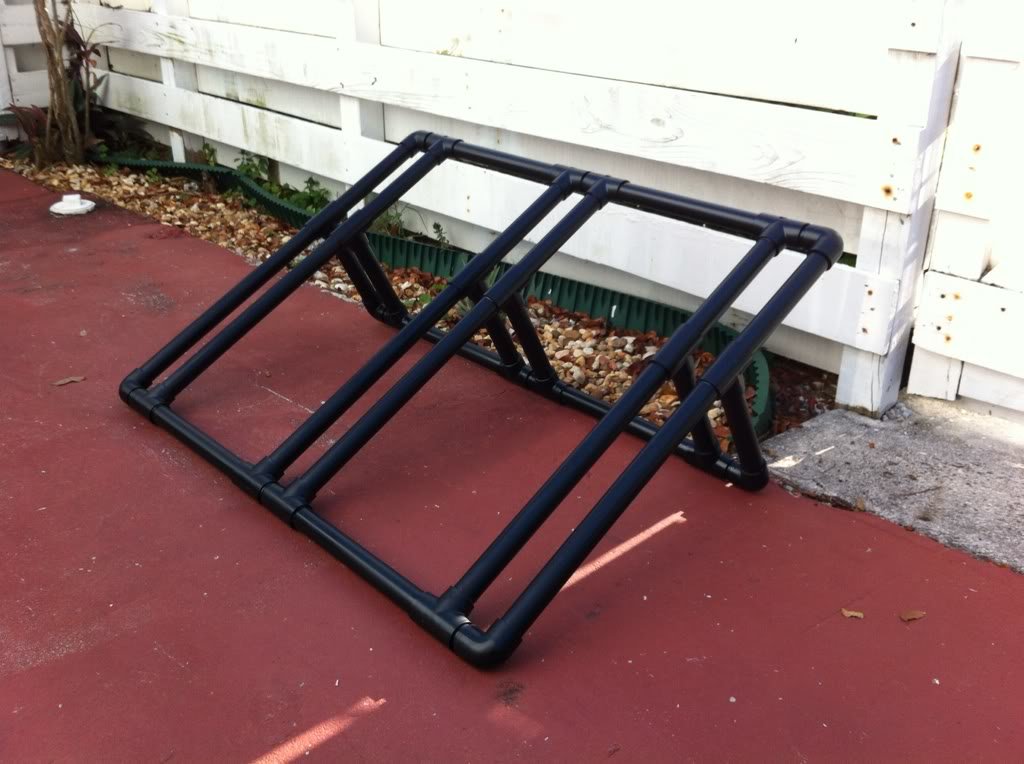

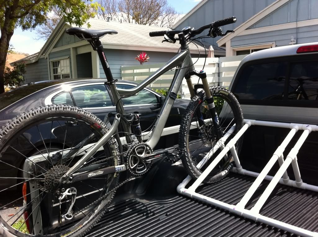

    Fairly new owner of a 1st gen Tacoma and also new to the forums...Anyway, here's what I did for my Tacoma - based on plans I found here on the forums but adjusted the size to fit my bed:

    Curious... I understand that's a bed rack probably, but how is it going to be orientated in your bed?

    Look now, edited with the first pic I meant to put up...

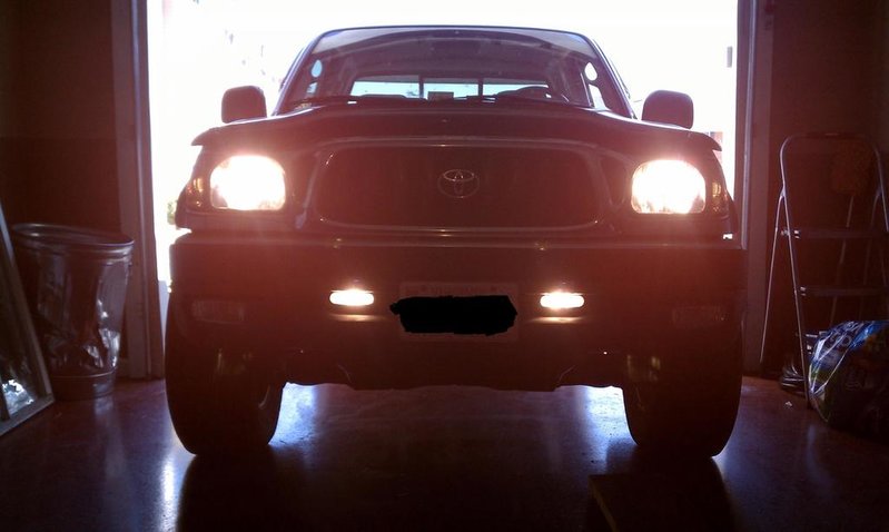

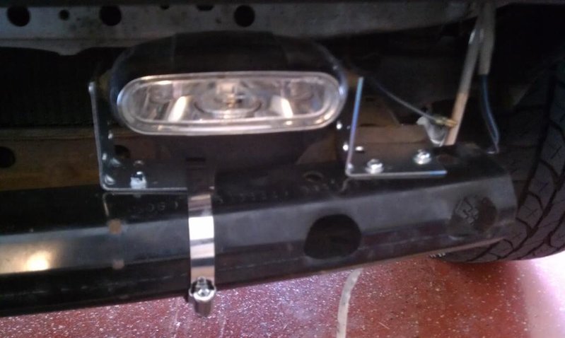

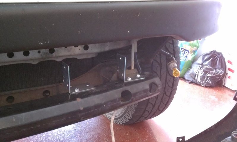

    So decided to permanently affix my fog lights to my truck. Before I had them on there with a bunch of zip tires and knew that would not be the permanent solution. Very firmly in place now. Took about 4 hours, with the added trip to Lowes to get a few things I realized I did not have.

    Very nice! I want to do something similar to that. What lights are you using?

    fogs are catz msx, bought em off of ebay for cheap, work great, only problem was they did not have the mounting brackets, so that is where Lowes came into play

    10-4 im looking at some hellas on autoanything.com like 67 bucks. Pretty sure they come with brackets. Look just like yours almost. Either way i love how you mounted them looks great man

    Gotcha, yea i just used some aluminum angle and cut it to size and bolted that to the rad support. No rattles! plus cost me all of like $5 for the little pieces i used lol
