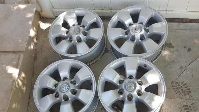

    Those are what I'm running. They definitely need spacers. I have Spidertrax 1.25" and 255/85 ST Maxx. They hit the frame hard at first. I plan on doing t5he tundra upgrade at some point but can't say for sure if it will work. I'm hoping so though :fingerscrossed:
    Specs though:
    Size 16" x 7"
    Diameter 16"
    Width 7"
    Lugs 6
    Bolt Pattern 139.7mm
    Offset 30mm

    Never heard that before. Pretty sure they are all the same. I have fj trail teams with no spacers. My buddy have 2nd gen off roads on his first gen without spacers...

    Sounds like he has small tires then.
    2nd gen wheels are almost a full inch more inboard then 1st gen wheels.

    I believe they are either 265/70 or 75. But my point being the wheels fit. Sounds to me like y'all are saying the wheels don't fit because the bigger tires dont fit. But i never saw the guy in the post mention a specific tire size, just tundra brakes.

    Not sure what the original problem is. But doesn't change the fact the wheels sit more inboard. And yes, anything over that size and you're doomed to rub somewhere without spacers.

    He was asking if those wheels would fit a first gen Tacoma with tundra brakes.

    Well, yes and no. Should clear the calipers fine. But will need spacers for anything over a 265 tire.
