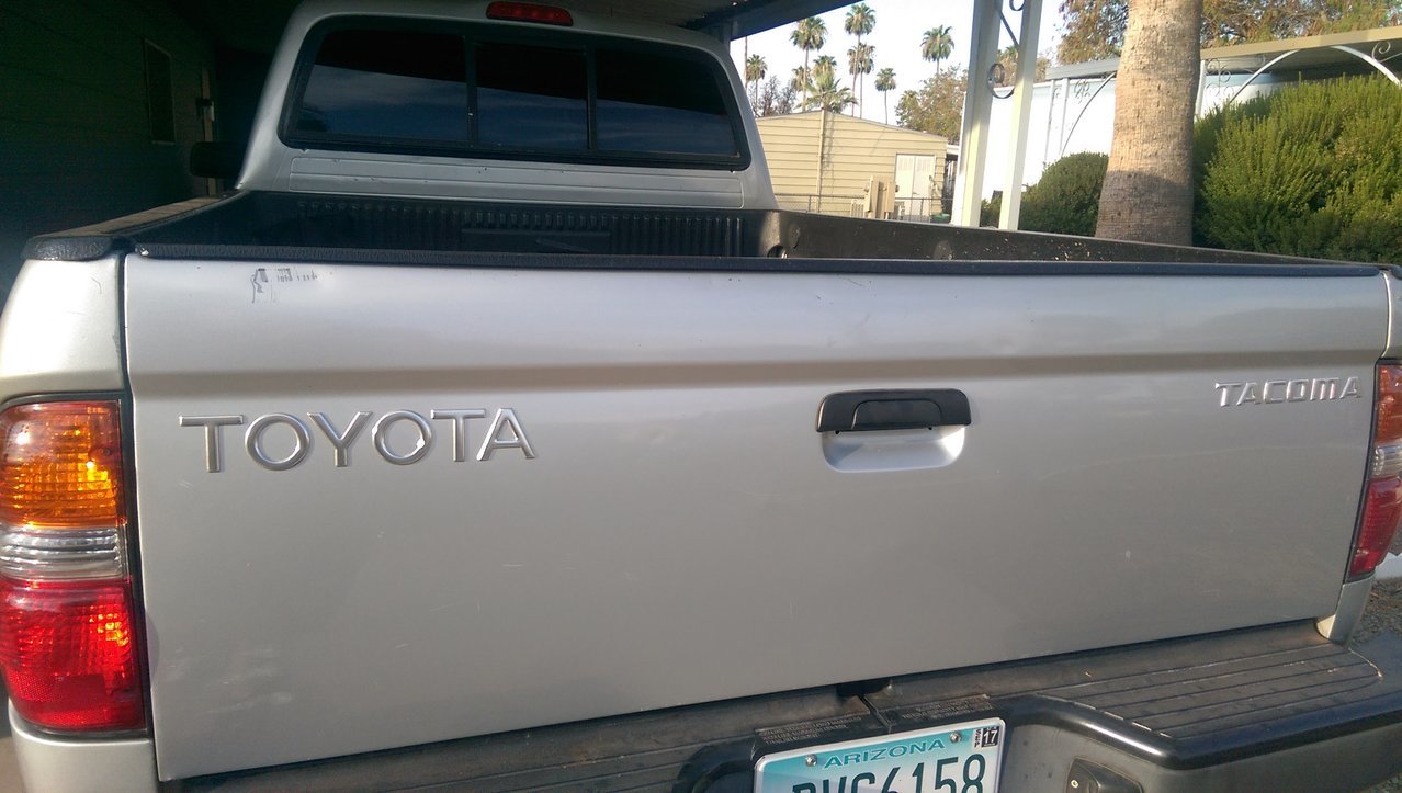

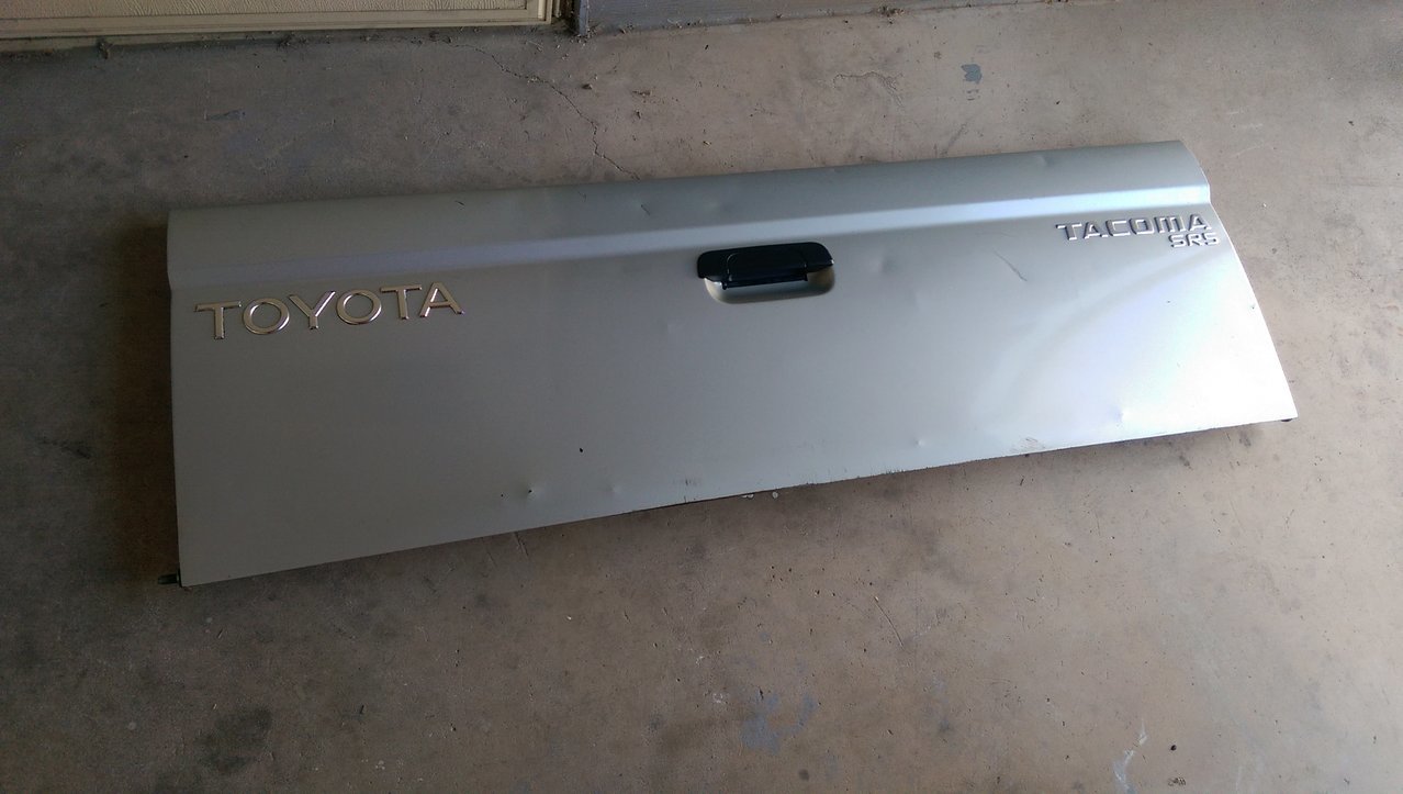

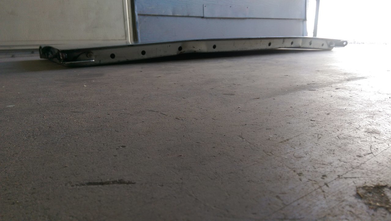

    Swapped my beat up tailgate with a slightly less beat up tailgate. Old...

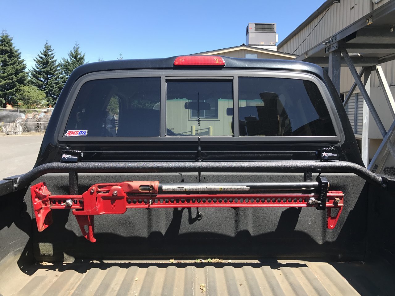

    Rhino lined the old Demello jack & light bar, replaced old backup lights with new Rigid LED's, and relocated the UHF/VHF antenna. :kona:
