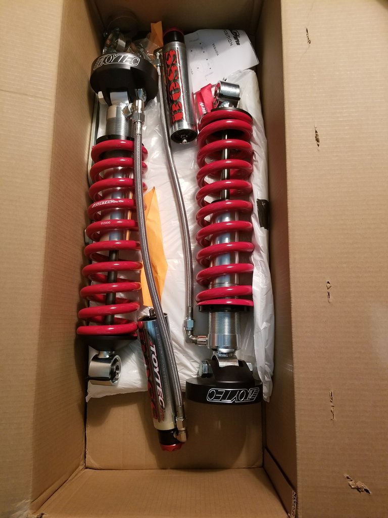

    Got these in today for the Taco

    Nice. How much you score those for?

    950$ after using the discount from TW

    Didn't have those when I got my standard Boss COs. Look much better. Wish I would have waited but I've just got a pee runner so they are good enough "especially" when properly adjusted. Can't tell from the pic but if they still have the dual ring adjustment without some sort of locking - set screw or otherwise, their adjustment will likely wander a bit over time. Mine have. I don't think it is a lack of "double nut" type bond between the two plastic rings. I just thing the two rings gradually unscrew together over time despite being opposite torqued with the spanner wrenches

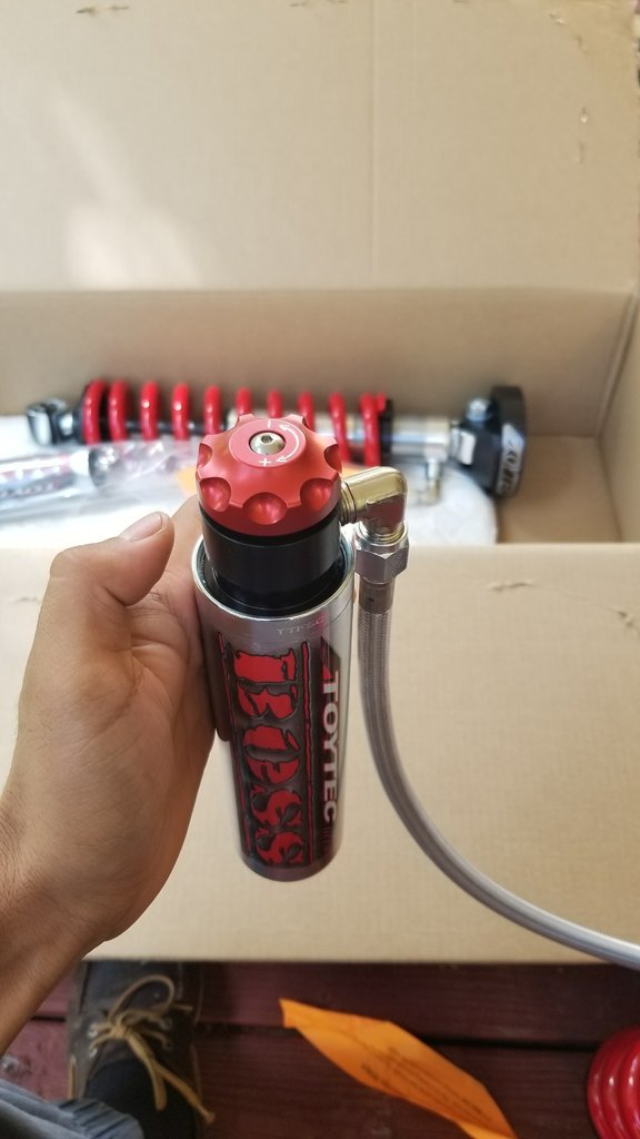

    This is the adjuster on the reservoir. I have a prerunner also but currently, I am converting it into 4x4. All I have to get is a front diff.

    What's your initial impression?

    So there is no up/down screw adjustment on the COs to raise lower it?

    Yea there is. Look at the small black piece on top of the coil itsself

    To raise or lower the coil?

    To add or reduce pre-load.
