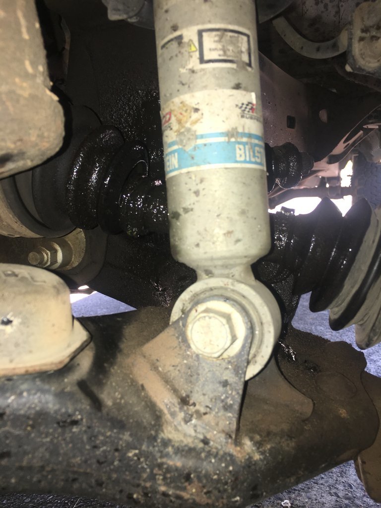

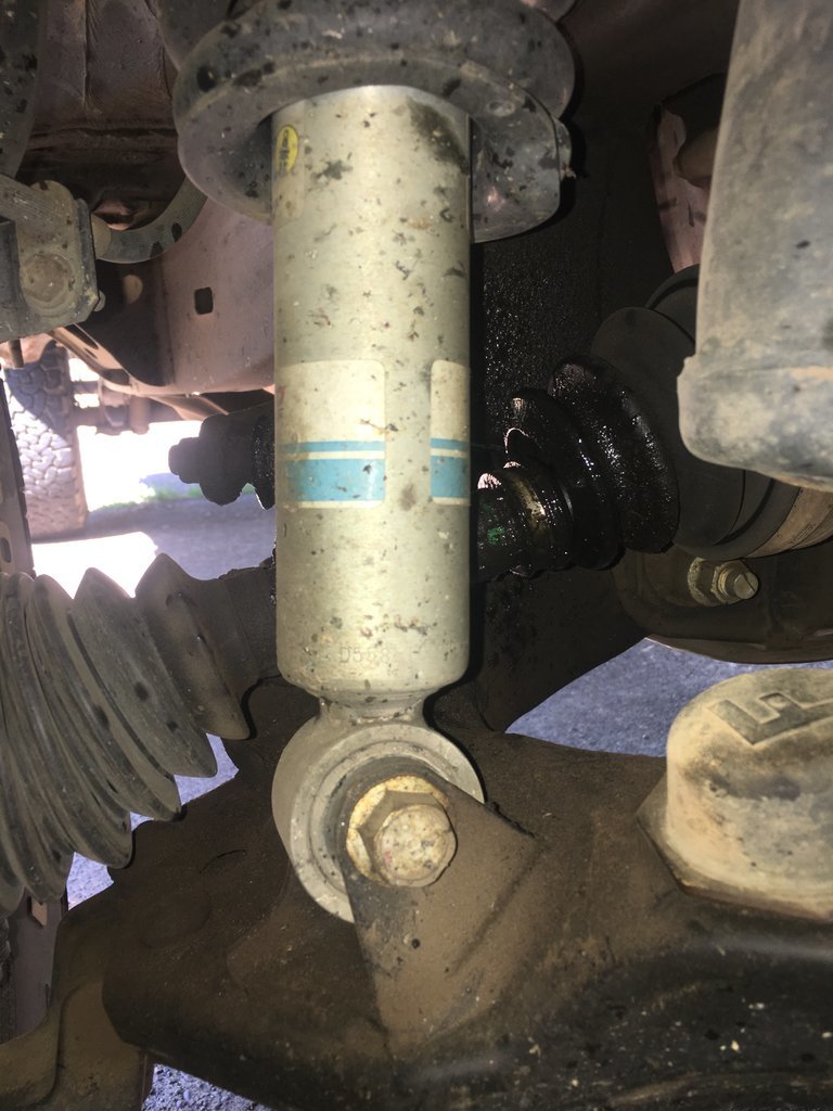

    I've put 4k on mine since the passenger one tore. Still kills it!

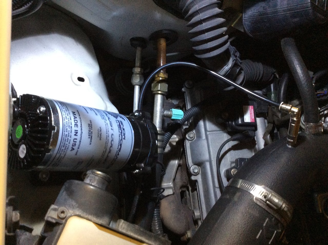

    My new add on this week is a methanol snow performance injection kit that cost
    475.00.
    This system has lots of positives going for it and works for me.
    It's inexpensive
    Easy to install
    It will get rid of the ping issues without having to spend 1000s for piggyback
    systems, injectors, fuel pump replacement and hours for installations
    Will add octave levels to 110
    Will cool the supercharger temps down by 100 degrees so you can add a smaller
    2" pulley without worrying about heat issues created by the extra boost to the nose seal or the supercharger
    Will clean the carbon from the top part of the engine
    Engine runs the best it has ever run now
    Should have done this along time ago
    If you have a supercharger even if u have the 7th injection setup I would highly recommend it.

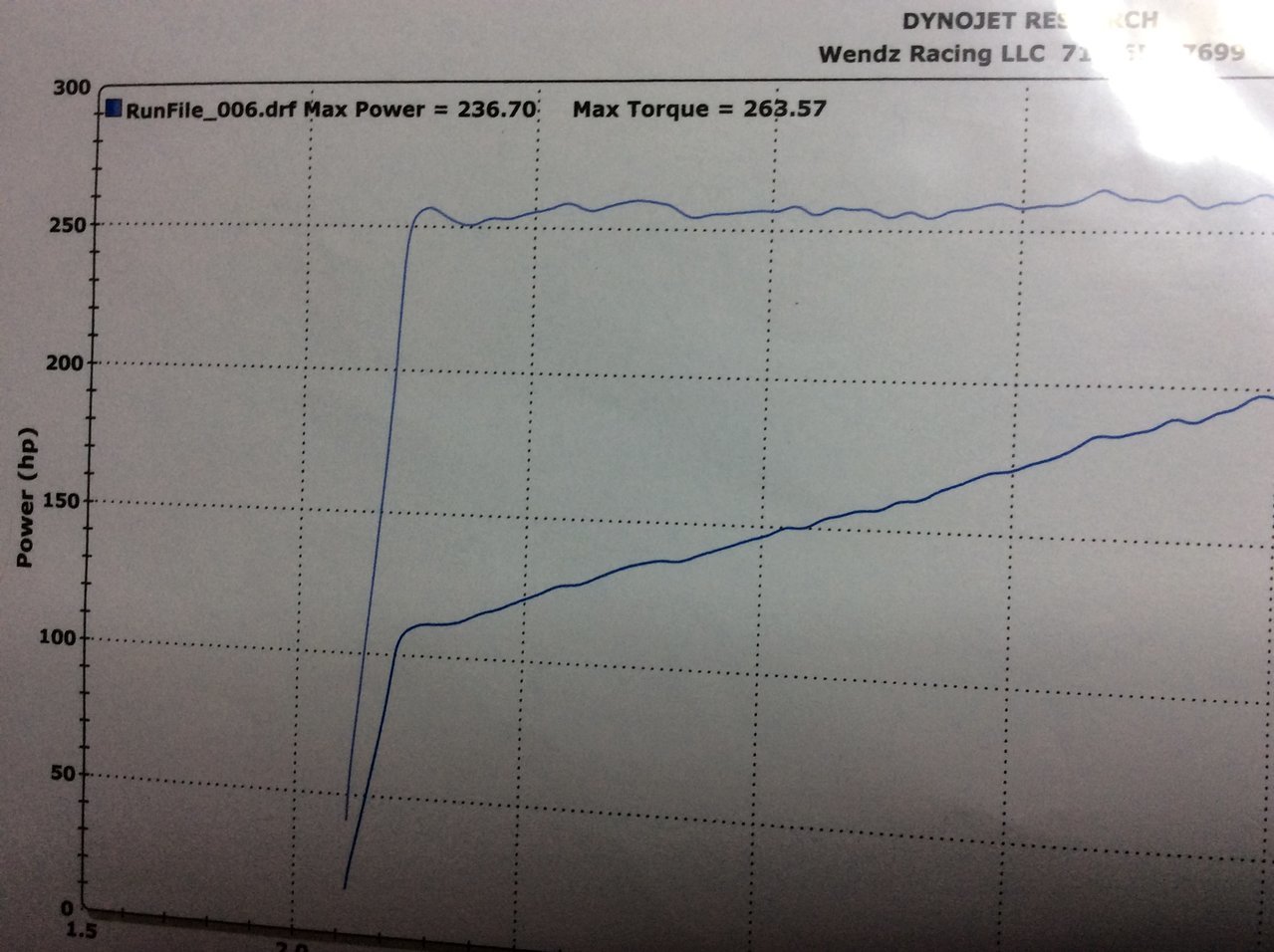

    Now my torque at the REAR WHEEL is almost instantaneous 265 ft pounds at 2000rpm :)) and running a perfect AIR FUEL RATIO. now all the way across the rpm range

    I can't remember are you running the urd kit?
    What tuning did you do with the Meth kit?
  18. Jul 17, 2017 at 8:07 PM
    1997tacomav6
    1997tacomav6 V6 5sp,RegCab,TVS1320 Supercharger,Haltech, 800k
    Oct 5, 2013
    #113940
    10,385
    John
    Denver
    97 reg cab, v6 5sp 300hp supercharged, Methonal Injection, 800,001 plus miles, Original Owner
    V6 5sp,RegCab,TVS1320 Supercharger, 56mm pulley, methanol injected Haltech ECU, AC Tvs1320 supercharger,(MUST DO) every 125,000- 150,000 needs rebuild Projector headlights HID 5 speed manual Amsoil for all drive train Smaller 56mm custom pulley, (MUST DO) 2004 DESNO fuel injectors, zero ping ping, 2004 side door mirrors Dick Cepek Rims, Michelin tires LTX, ATM Pathfinders Dynopro ATM ( that last 100,000 miles) Now running Dynopro ATM mud and snow tires KN cold air intake Cat back dual exhaust with ss exhaust tip, Raised exhaust tail pipe to 2" below body line Optima*dry cell battery,red top Alpine sirius radio, 200 watt amp, focal is165 split door pod speakers Focal door speakers Subwoffer behind seat Viper alarm, Electric Locks Dark tinted windows, bucket seats corbeau lg1 Tacoma Rubber floor mats TRD fender extenders, Bilstien shocks, King shocks JBA UCA trailer iv hitch, electric brake control, Drilled slotted brakes, High carbon steel (MUST DO) EBS green stuff 7000 series pads(MUST DO) TRD engine oil cap TRD stick shift, Marlin crawl shift kit. Rear sliding window 2002 4Runner functional hood scoop cut into Tacoma hood, 4Runner dual overhead map light Gentex Auto dim + Compass + Temp, garage,rearview mirror Snow Methonal kit stage 2 Custom 3 core aluminum radiator Linex bed liner Haltech stand alone ECU, Intake supercharger gauge. Stainless steel brake lines, Custom leather wrapped steering wheel, Haltech stand-alone ECU,
    No URD kit, No new fuel pump, no bigger injectors, no piggyback, No 7th injection.
    bought a snow performance kit, progressive for 475.00, had them tune the kit on the dyno,,nozzle size, and the spray timing at 4 pounds progressive up. Have a green light on my boost guage that shows when it's spraying 4 pounds of boost and up and a light for the low meth level. Now I have a perfect AFR all the way
    across the rpm range and can't make it ping even if I try.
