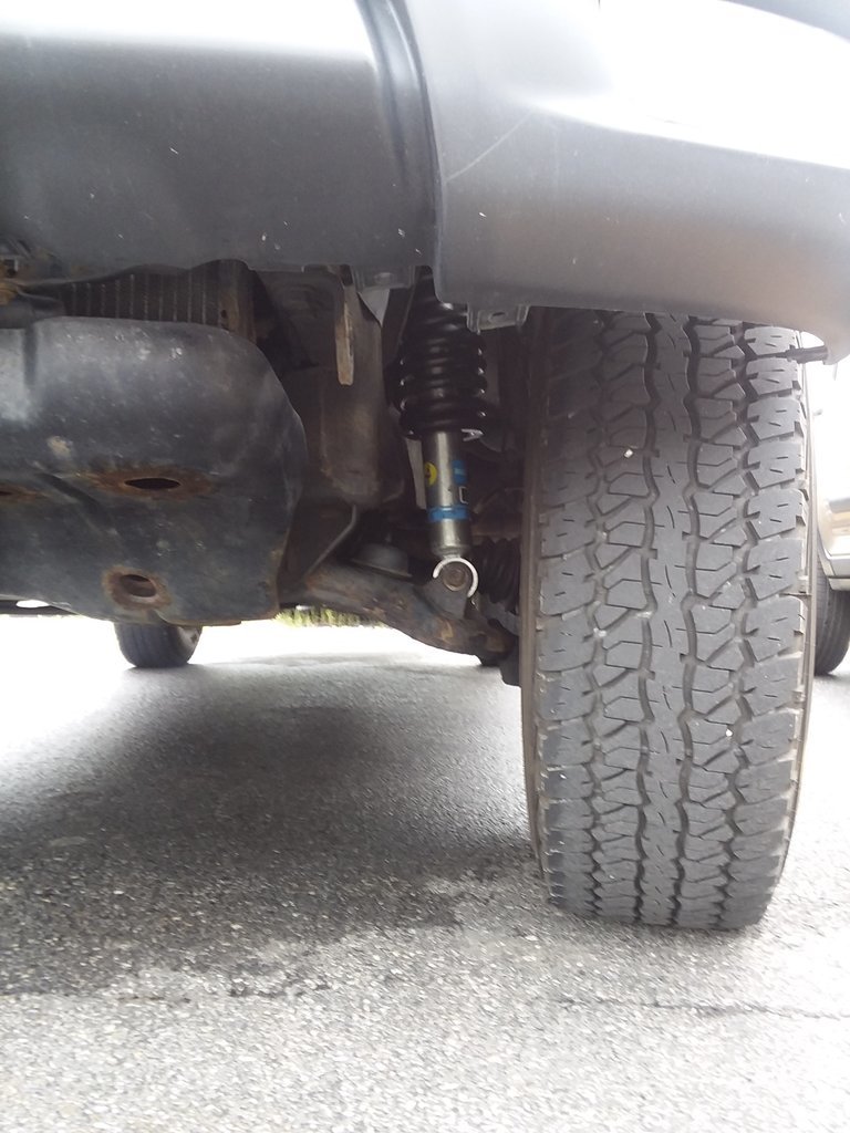

    I can hear your cv axles and ball joints screaming from here.
    In all seriousness. Loose the 3" spacer ASAP.

    And the tires because there's no way it's aligned riding at full droop.

    If you're adding a bumper a spacer is not the way to retain your lift. Again, the spacer moves your shock. Which in turn moves your shock travel. By adding a 3" spacer you shift the shock travel down 3" which means that you loose up travel because the shock will run out of travel when you compress it sooner than when it didn't have the spacer.
    If you want to retain your lift after adding a bumper/winch/skids/whatever. The best way is to change your spring rate. In other words, new or different coils.
    Seeing as you have 5100s adjustment isn't super easy, yet another pro to having full adjustable extended travel coilovers. 5100s do have adjustment though and you can pre compress the coils you have to make up for it.
    If you're on stock coils, you're screwed. You need beefier coils such as OME 882s or 883s.

    I have acdelco pro 779 springs

    What's the spring rate

    I HIGHLY doubt that. Link to product please

    i doubt thats the spring rate
