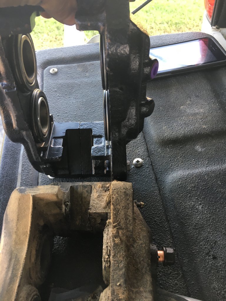

    Installing tundra brakes currently. The mounting surface for the caliper bolts is thinner on the 13WL caliper than the stock Tacoma caliper. This makes the stock caliper bolts too long to tighten down.
    Do people stack a couple washers under the bolt head or try to find a shorter bolt?

    I didn't have that issue, nor has anyone else to my knowledge.
    Are those stamped 13wl?
  18. Jul 18, 2017 at 5:05 PM

    I didn't run into that, Carter, and I just double checked that I am running 13WL calipers.
    I'm not sure what the deal is :confused:

    Yes, they are. I thought it was odd I hadn't seen mention of this in all my research reading. Ha ha.

    I wonder if the tundra bolts are shorter. Might stack some washer for now and investigate that possibility.
