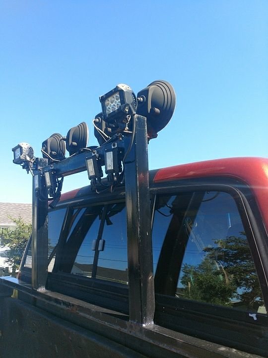

    put spare pods i had on the rack.

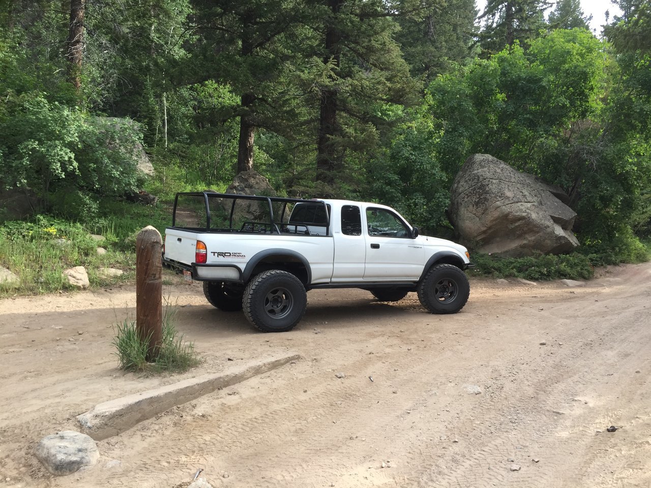

    Not bad, had to make an adjustment on the front bumper to fill the gap though.
